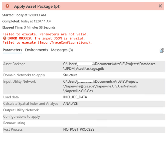

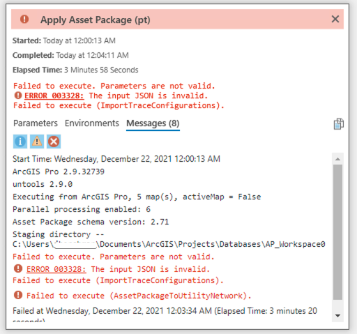

I downloaded the version 2.0 Gas and Pipeline Referencing Utility Network Foundation and am having issues building the Structure network.  I have gone through a couple times and encountered the same issue.
Any thoughts on the issue and how to resolve?
Thanks - Joe
Below is setup and errors.

I rebuilt the Asset Package from the Network geodatabase and got things to work.
