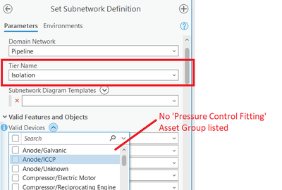

Sorry to ask another newbie question, but I'm stuck on this.

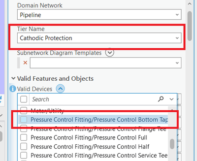

I added new asset group/asset types to the PipelineDevice class. I was then able to
add the new group/types to the  Cathodic Protection tier definition.
This was great.
Then I went to add the asset group/types to the Isolation tier definition.  However, this time the new asset group/types were not available to add (below).  Any clues on what I'm missing here would be much appreciated.
Thx,
Ed
MikeMillerGIS
Esri Frequent Contributor
In hierarchical, it must be valid in the parent to be allowed to add to the child.  Add it to System, then it will show as an option in the isolation.
MikeMillerGIS
EdwardBlair
Perfect!   Makes sense and works as advertised.  Thanks, Mike!
