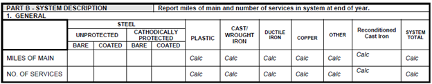

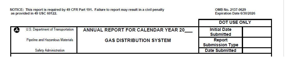

US DOT Annual Report for Gas Distribution
Every natural gas distribution organization in the United States is required to submit US DOT form F 7100.1-1 by March 15th each calendar year.
The effort of filling out this form, only requires of few hours of time. Officially the U.S. DOT Pipeline and Hazardous Materials Safety Administration (PHMSA) estimates the time to be 16 hours. The effort to gather and summarize the miles of pipe by material, size, decade of installation and the number of services by material, size, and decade of installation, as well other information can take several months.

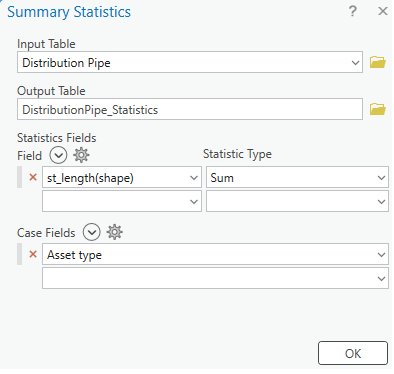

UPDM has been shown to significantly decrease the time to gather and summarize pipe asset data. UPDM accomplishes this time savings by first leveraging the geospatial representation of the pipes. ArcGIS automatically calculates the length of pipe for each unique pipe segment. Second, UPDM embeds the US DOT generalized material type into the AssetType data field on those same pipe records.
This eliminates the need to translate a company’s pipe material listings into the US DOT pipe material categories.
Tabulation of total miles of main categorized by US DOT material classification is a simple summarization of all installed distribution pipe (AssetGroup = Distribution Pipe) by generalized material (AssetType ).

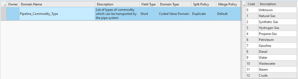

Part A, section 5 of the US DOT for Gas Transmission and Gathering asks for a separate report filing for each unique type of commodity flowing through the pipeline.
To simplify this division and summarization of pipe, UPDM embeds the same categories of type of gas into its commodity type listing.

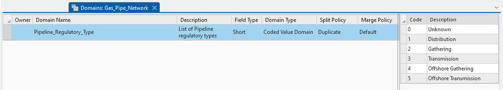

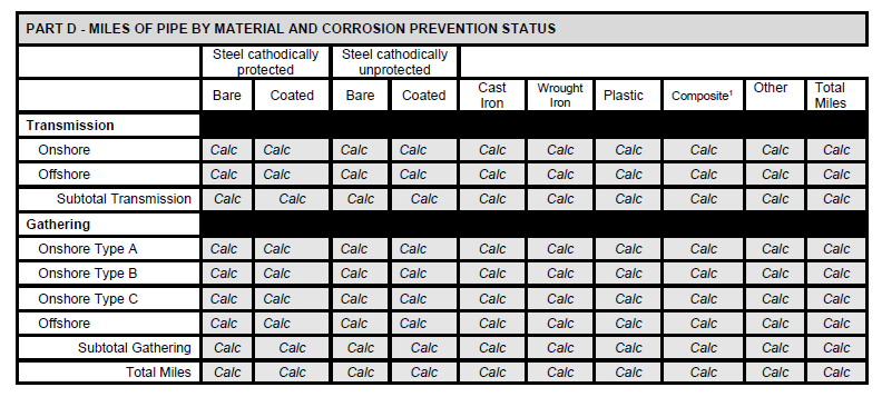

Part D of the report asks for pipelines summarized by material, and to differentiate between onshore and offshore.
The RegulatoryType data field on all pipe records encodes this differentiation between onshore transmission, offshore transmission, onshore gathering and offshore gathering.
The AssetType valid value picklist for transmission pipe and gathering pipe align with the federal reporting material classifications.
A quick run of the Summary Statistics tool can provide information needed to complete this portion of the US DOT report.

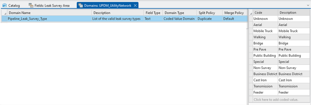

Leak Survey Compliance
The alignment of UPDM to federal regulations extends beyond reporting. It also includes compliance activities, such as leak survey.
The leak survey areas have types, that are based on the many regulatory types of leakage surveys.
Similarly, leakage reports are aligned with federal regulations and reporting. Classifications such as leak cause type are based on regulatory classifications.
