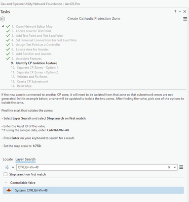

TravisSmith9
Task Create Cathodic Protection Zone
Step 9: Identify CP Isolation Feature
Layer search needs to be updated to state "CTRLlbl-Vlv-48"
I could not get it to find "cntrllbl-Vlv-48" as stated in the task currently.
Trying cntrllbl-Vlv-48
Trying CTRLlbl-Vlv-48 worked great.
KA_MR
Occasional Explorer
case-sensitive collation perhaps?
