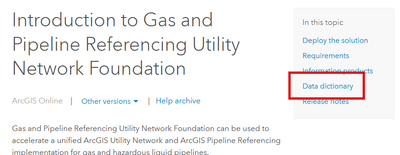

RobertKrisher
@SanneMikkelsen here is the link to the current data dictionary: UPDM_dynamic. The links to the data dictionaries can change slightly over time (in this case the change to the dynamic html report broke teh link). The most reliable way to access data dictionary for a solution is to visit the solution and use the link in the solution overview to access the data dictionary:
