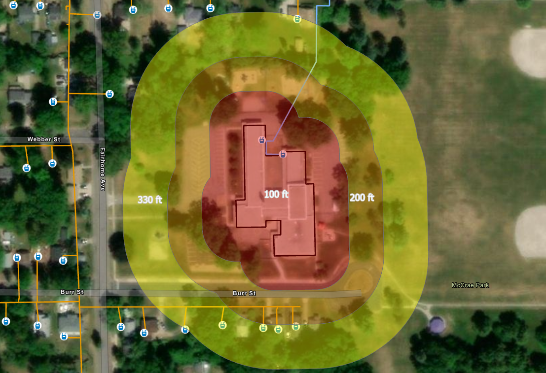

Given the Task Force’s findings, one approach we expect to see more of is the designation of different zones based on specified distances from a building. The zone closest to the GFO being the highest risk zone, the one furthest away the lowest. This is where a modern GIS can play a significant role. GIS can present all responders and those supporting them with a common operating picture indicating both levels of risk within a certain distance of a building and the location of pipe network components that can isolate the area to make the building – and them - safe.
An early example of this approach was highlighted at Esri’s 2021 IMGIS Conference in a presentation titled “How close is too Close?” by Lindsay Dreckman of the Metropolitan Utilities District of Omaha, Nebraska (M.U.D.).
Based on the work done by the Task Force, M.U.D. knew the distances from GFO incidents where most fatalities and injuries occurred. M.U.D.’s goal number one was to create a tool to generate three safety zones. Looking at the M.U.D. GFO emergency response policy, those zones include Exclusion, Hazardous, and Risk-Reduction. The Exclusion Zone is from the building’s exterior wall to 100 ft and where zero of our personnel are permitted to access. From 100-200ft is the Hazardous Zone, where work can occur but only after coordination with the public safety incident command. And from 200-330ft is the Risk-Reduction Zone, where we can establish a command post but with protection from a potential explosion.
It is important to remember that this is an emergency event. Field crews and first responders need both an immediate visual aid and an automated warning to inform them of these safety zones.
A mobile application with an interactive map, such as ArcGIS Field Maps is ideal for this need.  Here is an example highlighting that capability. When this mobile application is loaded onto the field technicians’ phone, or tablet, they will have a mobile device that informs them of these risks. This is possible because today’s mobile devices are location aware. The map can display their location with imagery of the area and the safety zones overlayed.

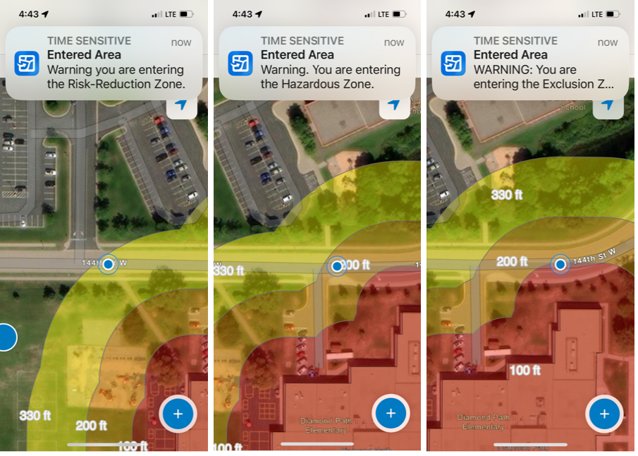

SafetyZones on Phone.jpgRecent enhancements to ArcGIS Field Maps now enable client side notifications based on that mobile device location awareness.  This is called geofencing.  With geofencing the same field technician can have their mobile device vibrate, make sounds and have a banner notification appear on the mobile device when they approach the safety zones. This client side notification is unique because it works regardless of the phone connection to the network.
