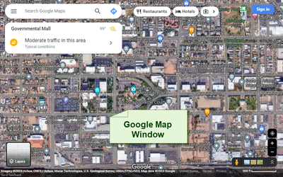

This is how your Widget appears:
It tracks the Lat/Long Coordinates as you move the cursor over the map.
When you click on the [Link], it opens a separate Google Maps Window.
https://www.google.com/maps/@33.44849,-112.09398,1131m/data=!3m1!1e3?entry=ttu
Hover your mouse over the Map Layers thumbnail.
Select More
Activate Globe View
Turn on the Satellite Imagery
You can now use your mouse wheel to zoom in/out.
You can hold down the Control Key while dragging your mouse to get the full 3D experience in Google Maps.
To change the Tilt, move the mouse up or down while holding down the Control Key.
To change the Rotation, move the mouse to the left or right while holding down the Control Key.

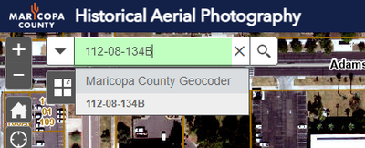

Here is our highly popular Historical Aerial Photography App.
https://gis.maricopa.gov/GIO/HistoricalAerial/
You can enter this Parcel Number in the Search Tool = 112-08-134B
The map will zoom to the Arizona State Capitol Building.

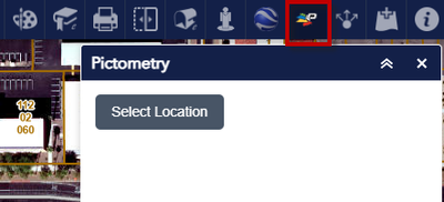

Open the Pictometry Widget.
You get a button to Select a Location.
Click on the State Capitol.

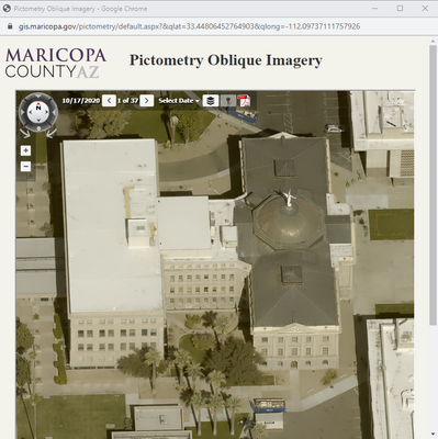

This opens a separate Pictometry Window with this URL:
https://gis.maricopa.gov/pictometry/default.aspx?&qlat=33.44806452764903&qlong=-112.09737111757926

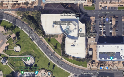

The Google Map Widget launches the Google Maps Window.
https://www.google.com/maps/@33.44849,-112.09398,518m/data=!3m1!1e3?entry=ttu
