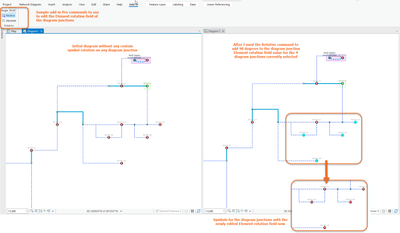

However, we provide a Pro add-in sample code with custom commands that you can use to easily rotate diagram junction symbols like you expect! This add-in command edits the Element Rotation field of the diagram junction, then the newly edited Element Rotation value can reflect on the diagram junction symbol like in the graphic below 🙂
NOTE: if you store your diagram, these Element Rotation field value will be kept with your diagram. Each time you open your diagram, it opens with the custom symbol rotation you edited
