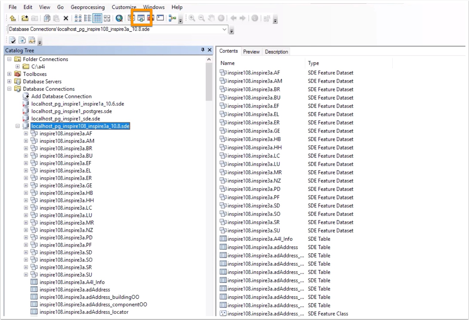

Load the Geodatabase in ArcMap
Go to ArcCatalog and open the database connection to view its contents. Here we see the geodatabase organized thematically by feature datasets.

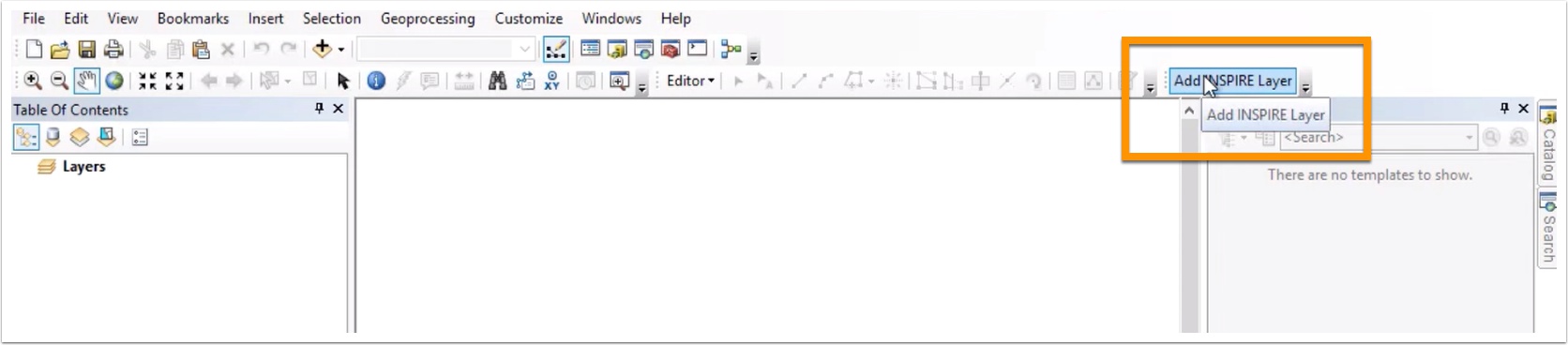

Add INSPIRE Layer(s) to create an INSPIRE map document in ArcMap
In ArcMap, click the menu button 'Add INSPIRE Layer' to launch the INSPIRE Layer Wizard (this button is available when the ArcGIS for INSPIRE extension is installed and tools have been added).

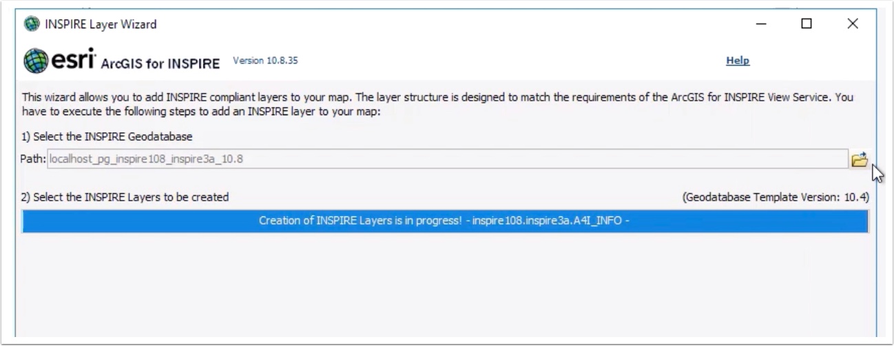

In the INSPIRE Layer Wizard, click the folder icon to see the INSPIRE geodatabase selector dialog, then choose the GDB connection and click 'Add' button.

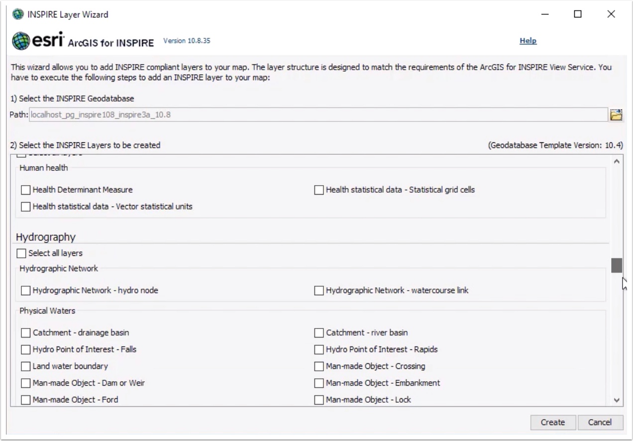

The extension will check the GDB, analyze it, and try to find what feature classes that are available. It will then display a list of feature classes you can choose to load as layers into your map.
Select the INSPIRE Layers to be created
Here you see the list of layers. We have sample data for Transportation Networks, so we scroll down to the Transportation Network theme and click the check box to select all the layers, then click the 'Create' button.

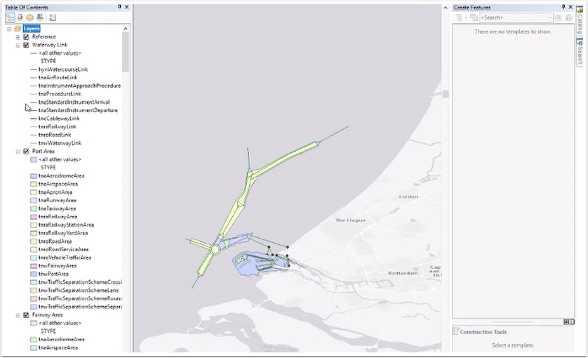

The Wizard loads all the Transportation Network related feature classes and tables into ArcMap.
The Table of Contents displays the feature layers and related tables, displaying the layers in the map window. To provide context, this screenshot shows we have added a basemap in the background. Do not include basemaps when publishing the INSPIRE View Services.
Note, the INSPIRE Technical Guidelines require specific symbology be used for View Services on several themes. Our example shows the default ArcMap symbology. During publication of your INSPIRE View Services, the ArcGIS for INSPIRE extension will automatically apply the appropriate symbology according to the INSPIRE specification.

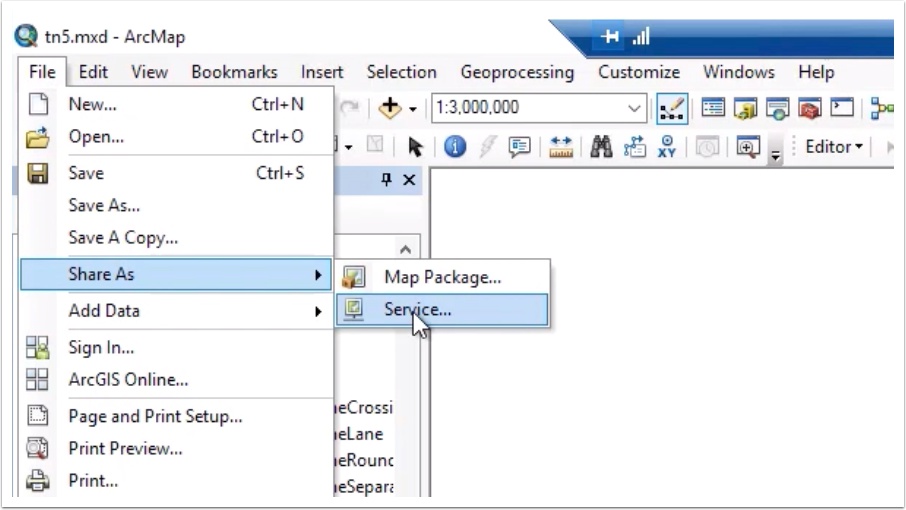

Share as a Service
In the main menu, choose 'File > Share As > Service…' to open the Share As Service dialog. Choose 'Publish a Service' and click 'Next'.

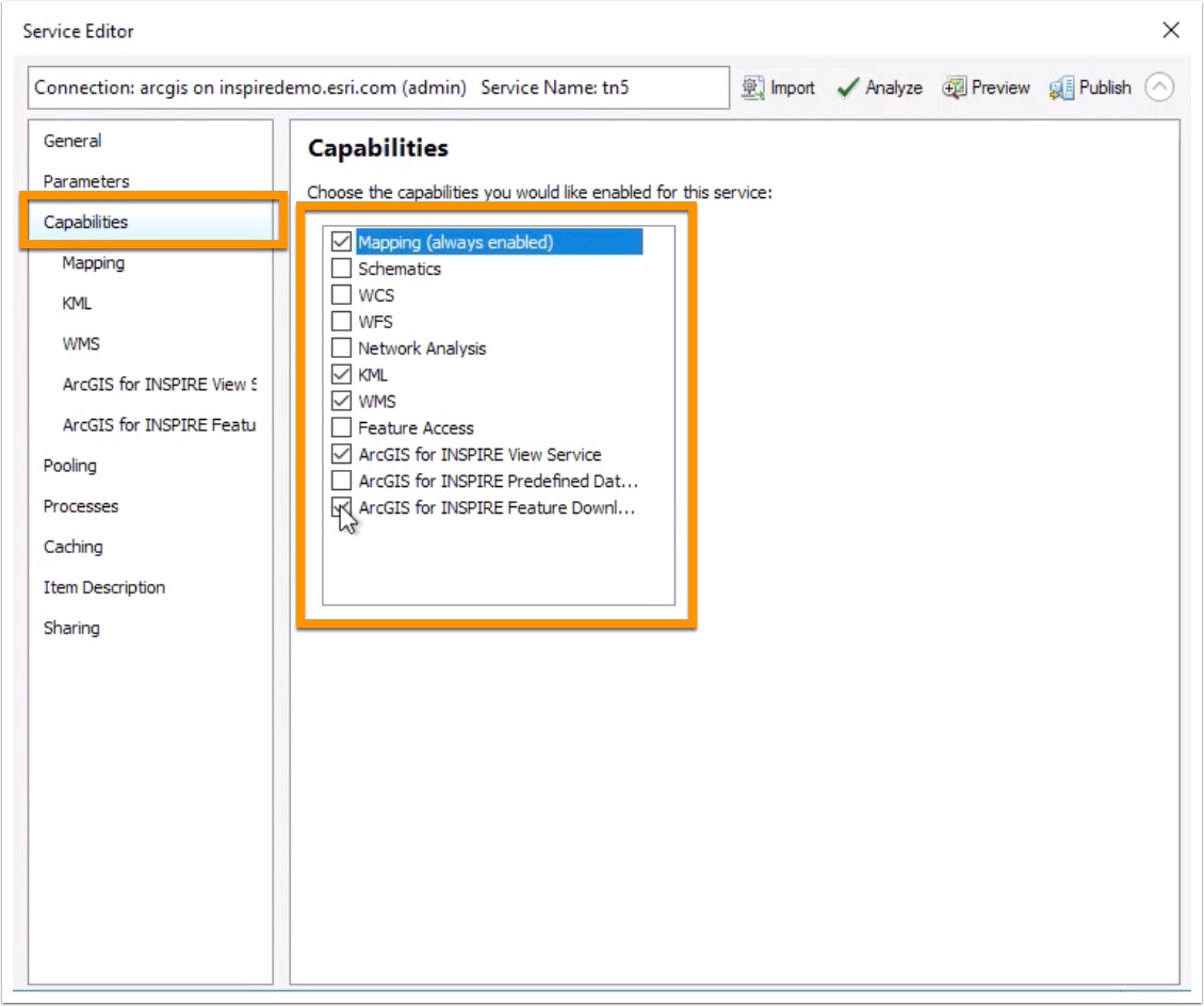

Configure the Service

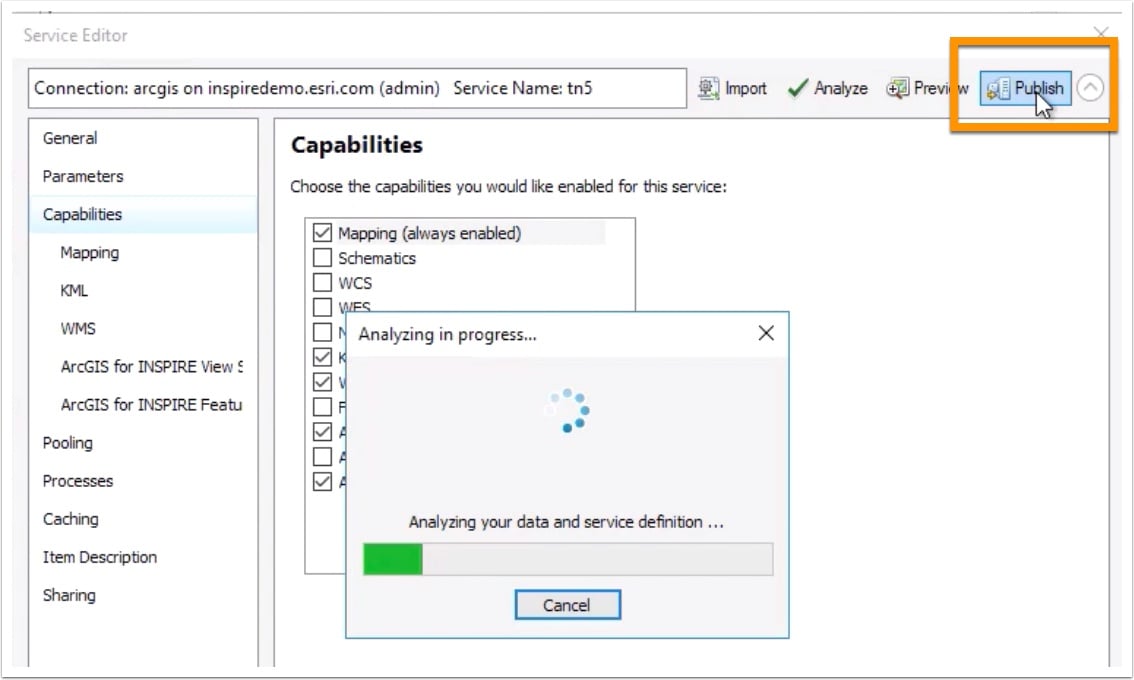

Choose 'Capabilities' in the left sidebar to choose the capabilities you would like enabled for the serice. Add WMS, ArcGIS for INSPIRE View Service, and ArcGIS for INSPIRE Feature Download Service.

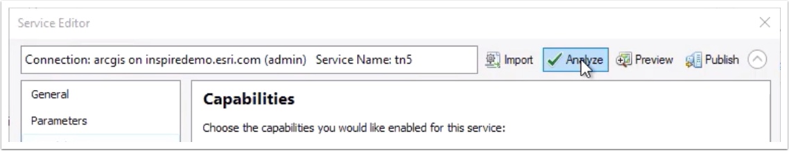

Analyze the Service
In the Service Editor, click 'Analyze' if you would like to check for issues. Low severity issues are not typically a problem for producing valid services.
Publish the Service
In the Service Editor, click 'Publish' to package the service. It will take some time to publish the INSPIRE View and Download Services with the proper configurations.

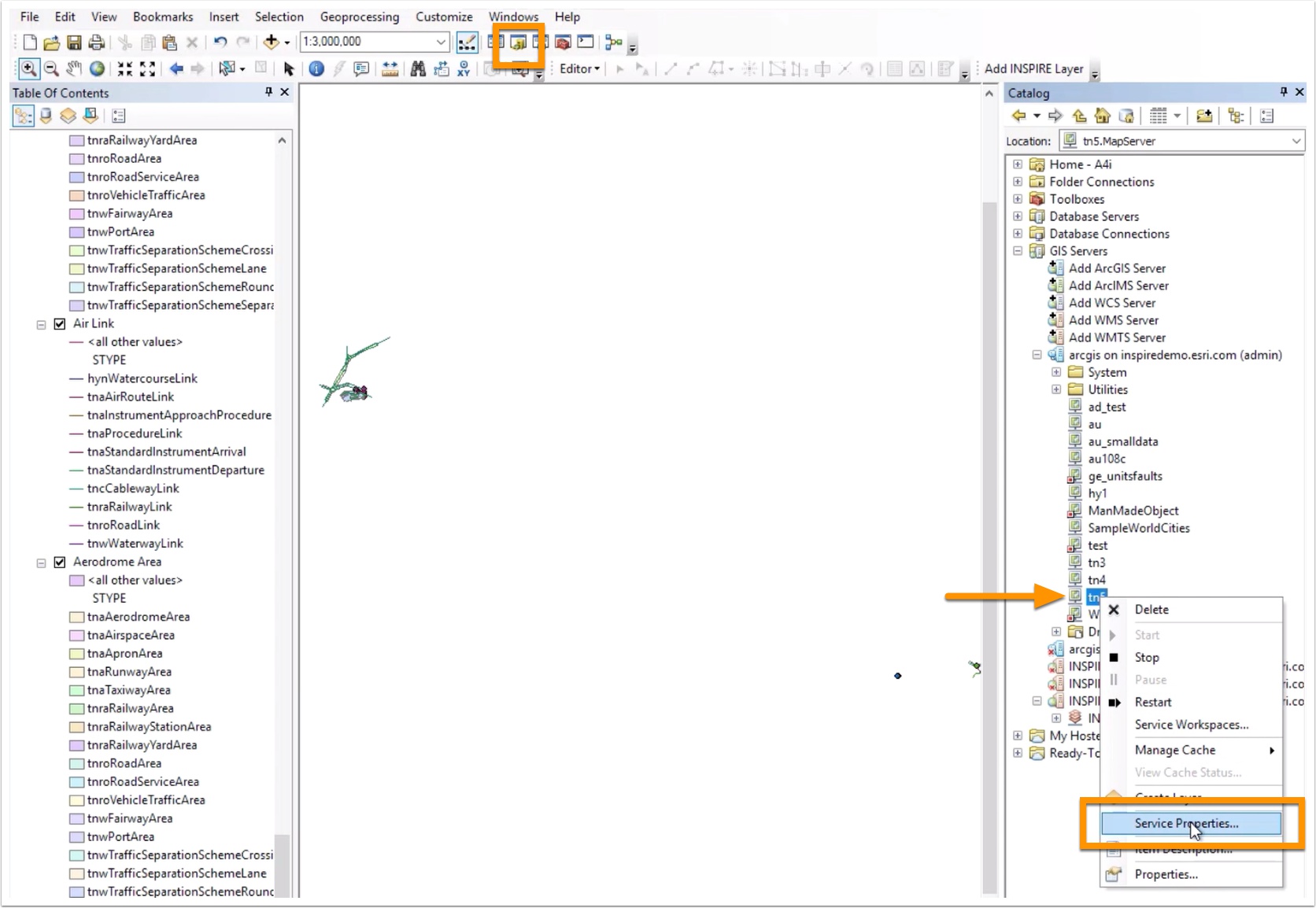

Edit your newly created service
Once the service has been published, we go to the ArcGIS Catalog to connect to the server instance and see the service. Right-click the service and choose 'Service Properties…' to open the Service Editor.

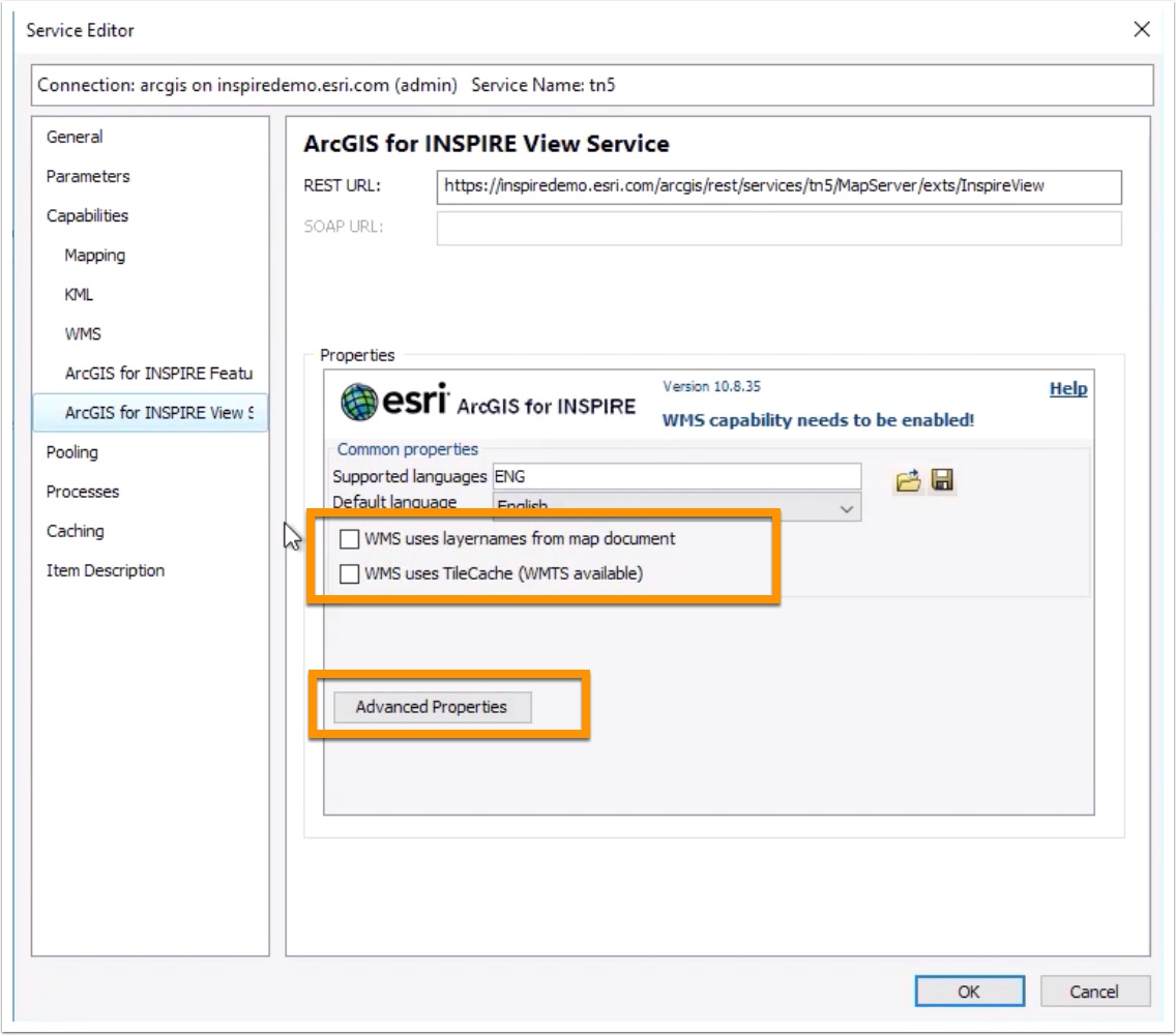

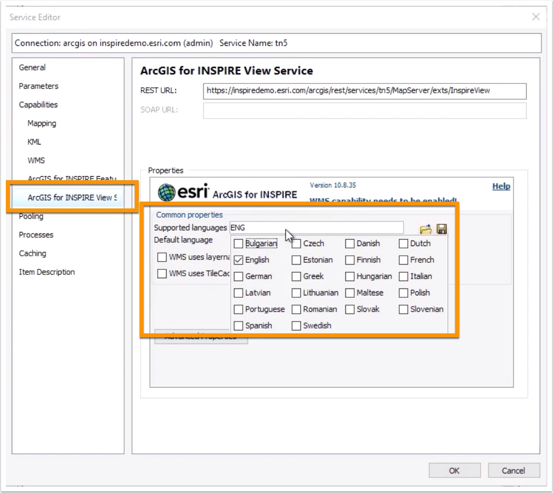

Enable the INSPIRE View Service Supported Language(s)
In the Service Editor left sidebar, select the properties for the ArcGIS for INSPIRE View Service. The dialog for the View Service will open.
In the Service Editor dialog, click in the language text field to display and choose from supported languages according to the INSPIRE specification.
Enable the INSPIRE View Service WMS and WMTS Capability
Check the 'WMS uses layer names from map document' check box, and optionally check the 'WMS uses TileCache (WMTS available)' check box to enable the INSPIRE View Service using OGC Web Map Tile Service (WMTS).
Next, click the 'Advanced Properties' button to open the Edit View Service Properties dialog.

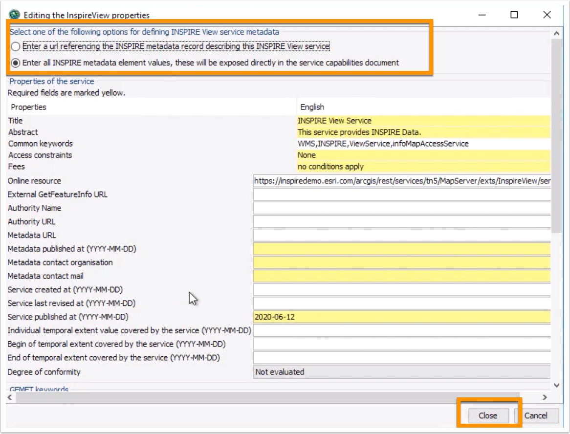

Edit the INSPIRE View Service Properties
The INSPIRE Directive requires specific properties for metadata to be used in the INSPIRE Service capabilities file beyond the default used by ArcGIS. ArcGIS for INSPIRE helps simplify this task by pre-filling the required elements where possible, and guiding you through the others. Required elements are highlighted in yellow.
According to the INSPIRE Technical Guidelines (version 3.1), the service provider can choose how to provide metadata about the service. This can be set using the following options at the top of the INSPIRE View service properties dialog box:
Enter a URL referencing the INSPIRE metadata record describing this INSPIRE View service—Enter a URL, from an INSPIRE Discovery Service (Geoportal Server), that references a metadata record that describes the View Service.
Enter all INSPIRE metadata element values, these will be exposed directly in the service capabilities document—Enter all INSPIRE metadata element values using the INSPIRE View Service properties configuration page (these elements are exposed directly in the service capabilities document).
If you choose the second option, you see a dialog box as shown below. Fill in the required yellow fields, being sure to use the (YYYY-MM-DD) date format. Accept the pre-filled default values as desired.
See the online guide, Configure INSPIRE View Service properties, for more detailed description of values to use for these properties. When you have completed filling in the yellow fields, click 'Close' to return to the Service Editor dialog.

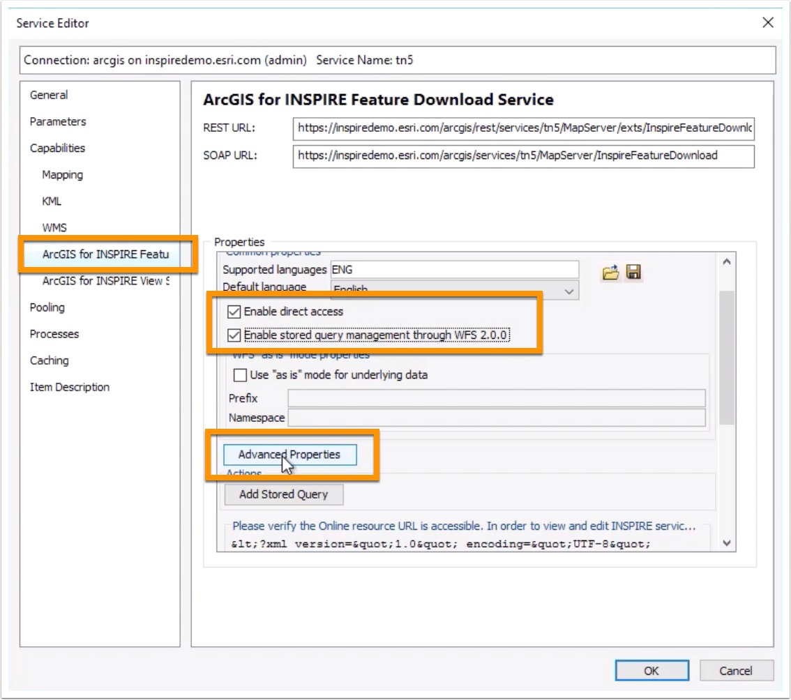

Enable INSPIRE Feature Download Service WFS Capabilities
In the Service Editor left sidebar, select the properties for the ArcGIS for INSPIRE Feature Download Service. The dialog for the Feature Download Service will open. As with the View Service, you can select the languages to be used in the service.
Click to enable the following:
Then click 'Advanced Properties' button to open the Edit Properties dialog.

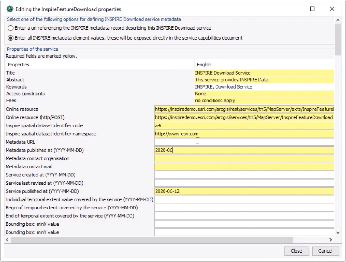

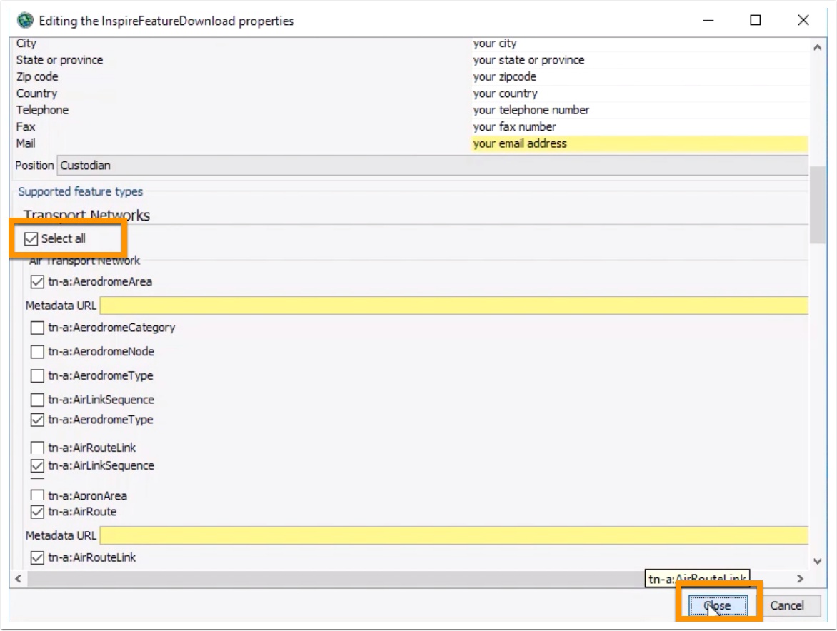

Edit the INSPIRE Feature Download Service Properties
As with the dialog for editing the View Service, fill in the required yellow fields.
Scroll down to select the theme feature types to include. Click 'Select All', or choose specific feature types as desired.
NOTE: INSPIRE Services and Service Metadata are co-dependent. Since we haven't created the INSPIRE Metadata reference, we can't yet provide the Metadata URL. We'll come back to edit the service after creating the Service Metadata.
Scroll down to choose 'conformant' or 'not conformant' when the service has been evaluated in the INSPIRE Reference Validator. If the evaluation passes, the degree is conformant; otherwise, it is not conformant. In this case, the service has not yet been evaluated in the INSPIRE Reference Validator so choose 'not evaluated'.
Click 'Close' to exit the editing dialog, and then click 'OK' to exit the Service Editor. The ArcGIS for INSPIRE Server extension will update the properties we just entered to finish.
