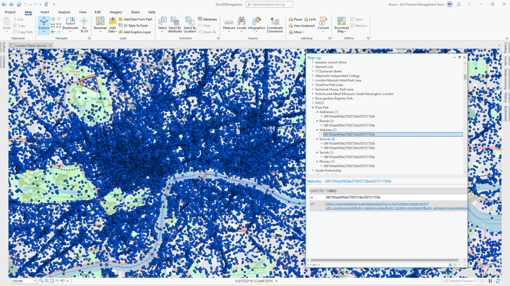

Places of interest in London, EnglandPlaces of interest in London, England
What you are looking at is a hosted  group layer in ArcGIS Online with 347,595 place of interest points in London, England, with related tables; 347,585 address details, 16,240 brand names, 262,183 website URLs, 458,534 source attributions, 246,398 social media link URLs, and 302,601 phone numbers.  Here is a chocolatier in Covent Garden:

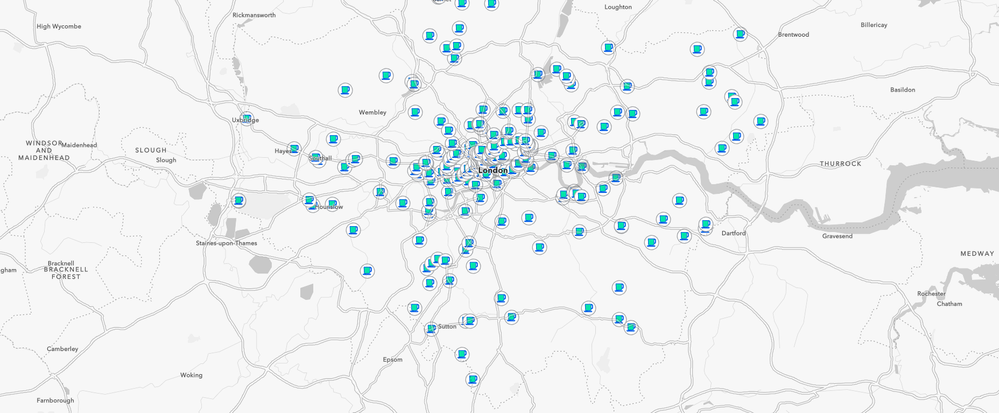

Chocolatier in Covent GardenChocolatier in Covent Garden
This being England, you might expect there are tea rooms about the city.  Using place category and related tables we can see not just their locations but their address, website, social media links and phone numbers:
Tea Rooms in LondonTea Rooms in London
Tea Rooms and related dataTea Rooms and related data

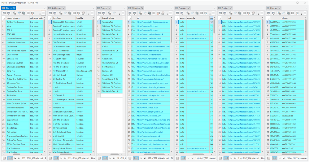

So, the above creates my point layer, then it is a matter of extracting each expansion table, which all follow the same pattern. Here is the code that extracts addresses from the Places view:
sql = """with address as (select id, unnest(addresses, recursive := true) from places_view where addresses is not null)
         select id, freeform, locality, region, postcode, country from address;"""
duckAddresses = conn.sql(sql)
arcAddresses = arcpy.management.CreateTable(out_path=arcpy.env.workspace,out_name="Addresses").getOutput(0)
arcpy.management.AddField(in_table=arcAddresses,field_name="id",field_type="TEXT",field_length=32)
arcpy.management.AddField(in_table=arcAddresses,field_name="freeform",field_type="TEXT",field_length=300)
arcpy.management.AddField(in_table=arcAddresses,field_name="locality",field_type="TEXT",field_length=100)
arcpy.management.AddField(in_table=arcAddresses,field_name="region",field_type="TEXT",field_length=50)
arcpy.management.AddField(in_table=arcAddresses,field_name="postcode",field_type="TEXT",field_length=100)
arcpy.management.AddField(in_table=arcAddresses,field_name="country",field_type="TEXT",field_length=2)
with arcpy.da.InsertCursor(arcAddresses,["id","freeform","locality","region","postcode","country"]) as iCursor:
    row = duckAddresses.fetchone()
    i = 1
    if row:
        while row:
            if i % 10000 == 0:
                print('Inserted {} Addresses rows at {}'.format(str(i),getNow()))
            iCursor.insertRow(row)
            i+=1
del iCursor
Note the fancy "unnest" operator in the SQL.  This expands the array of address structs into new rows for each address, inheriting the id field for each expanded row.
