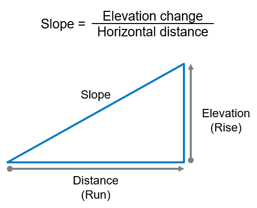

How to calculate slope
Let’s first break down the slope calculation to understand your specific data needs better. The slope is calculated by dividing the elevation change by the horizontal distance covered. This is sometimes called “rise over run.” The output value of this calculation can be multiplied by 100 to get a percentage value.
When a surface layer is unavailable to calculate elevation values, you must use either attribute values or Z-values from the line feature. The elevation change can be calculated by subtracting the starting elevation from the ending elevation, and the distance value can be accessed from the shape length.
