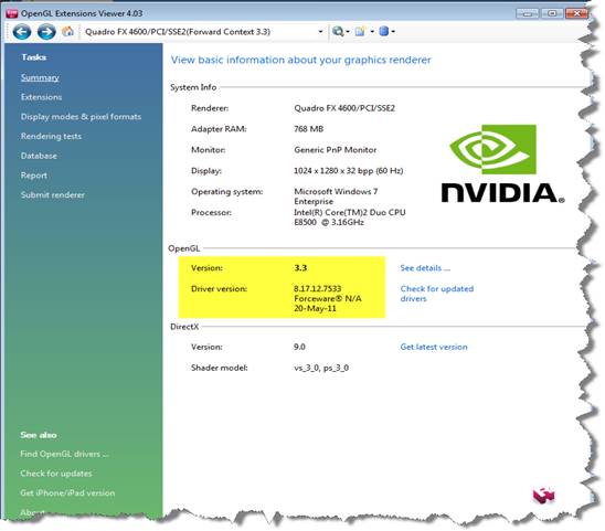

To discover what version of OpenGL exists on your PC, follow these steps.
  1. Install an OpenGL viewer, such as the GLview utility, to view the OpenGL version installed on your machine.
  2. For Windows XP, Windows Vista, and Windows 7, open the viewer to find the version and driver version under OpenGL running on your computer.image002.jpg

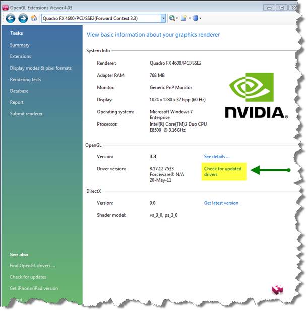

  3. Click the “Check for updated drivers” link to identify if any driver updates are necessary.image004.jpg
