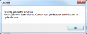

Also, keep in mind if you are not the administrative user you will receive an error message to contact your geodatabase administrator to make the database connection and update the license for the geodatabase:not_admin-300x118.png
