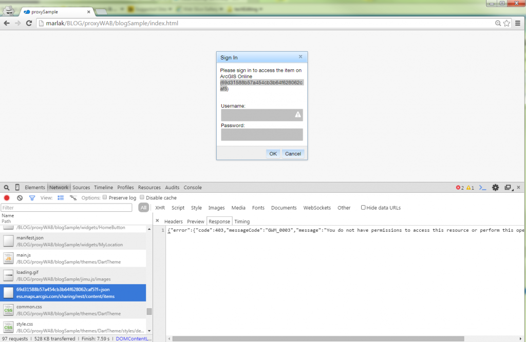

When we open the developer tools and take a look at the Network tab, we can see that the response returns a 403 error when accessing the ArcGIS Online web map. This is because by default, an anonymous user doesn’t have permission to access this resource.
challenge for securing a web map

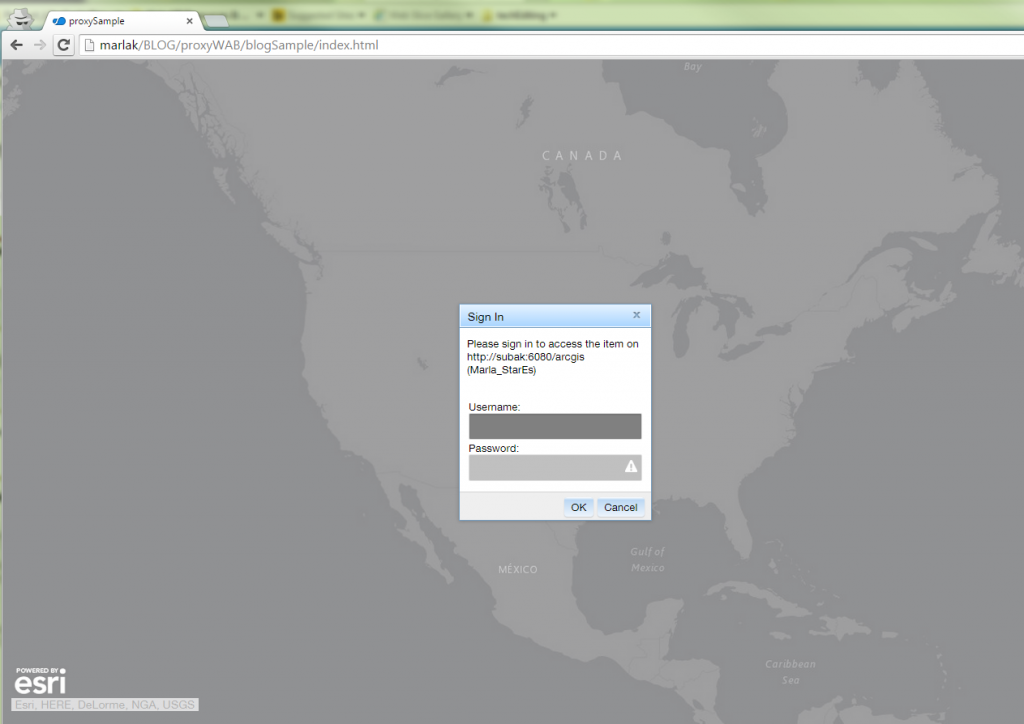

For the second challenge, we see that in the Network tab, the application fails to load the service, returning a 499 token required error. This tells us that to access the content, we need to pass a token.
challenge for securing an ArcGIS for Server map service

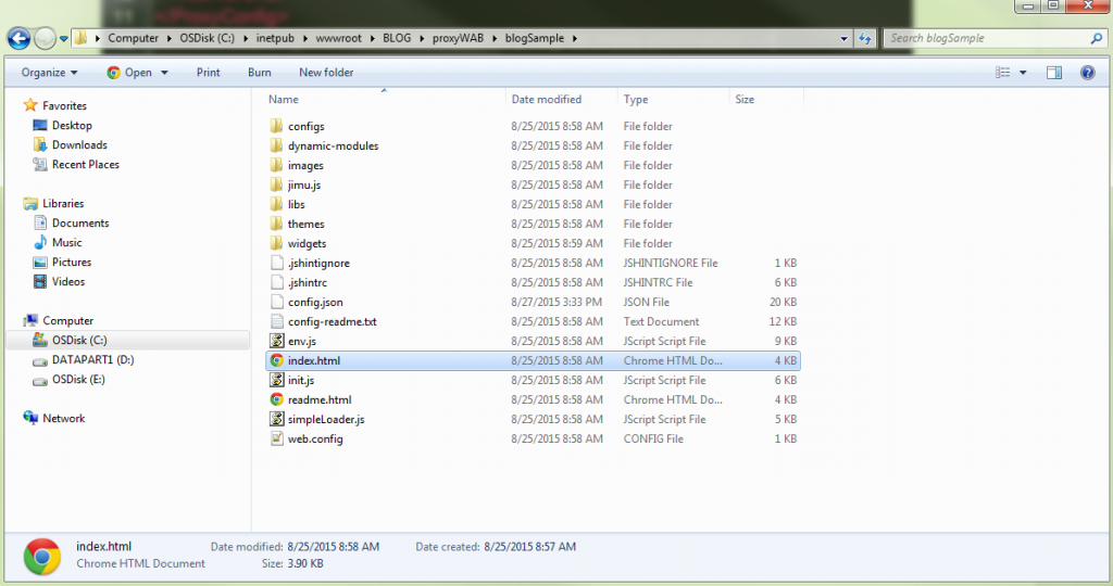

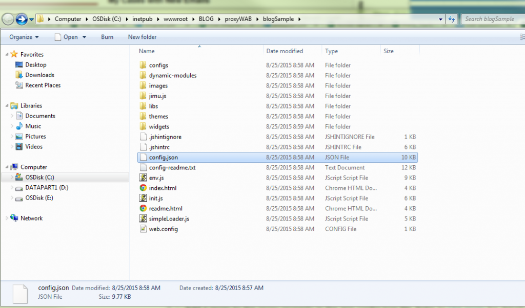

1. In Windows Explorer, open the application's "config.json" file. configJSONFile-1024x602.png

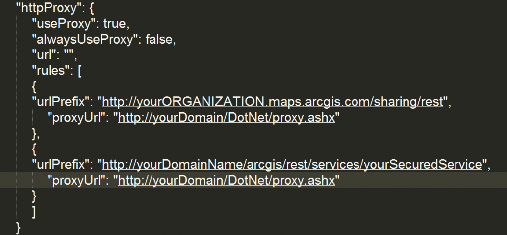

2. At the very bottom of the file, there is a cozy spot to add the proxy rule to the application. useProxy_WebAppBuilder_20151028.jpg
The parameter useProxy (Boolean) is set to true by default. If it is set to false, all requests will not use a proxy.
The url (String) parameter is optional, which is the URL of the proxy location. When a request must use a proxy for a Cross Domain request, or a request is larger than 2048 characters, this proxy will be used.
The alwaysUseProxy (Boolean) is also optional and set to false by default. If set to true, all requests for communication to a REST endpoint will use the proxy set in the url parameter.
The rules (Object[]) parameter is also optional and, if set, defines specific requests that will use the proxy.
3. Since we have two secured resources, we can channel the requests through the proxy to authenticate. To do this, we need to add some proxy rules to the config.json file.
proxy rules
The first rule is for the web map shared to the organization, and the second rule is for the secured ArcGIS for Server service.
The urlPrefix property tells the application that when you see this prefix in the request, use the proxy to access the resource. The proxyUrl property tells the application where the proxy is located.

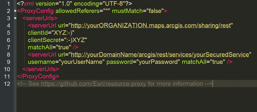

4. Set up the serverUrls in the proxy.config file. Since we have two rules, we will also have two serverUrls.
When working with content secured in ArcGIS Online (such as a secured web map or a secured hosted feature service), it is highly recommended to use a client id and client secret to authenticate. We will be using an ArcGIS for Server username and password for services hosted on ArcGIS for Server.
Need help registering an application to get a client id and client secret? There are two ways to do this! The choice is yours, and yours alone...they produce the same results; it’s just your personal preference.
serverUrl in the proxy.config

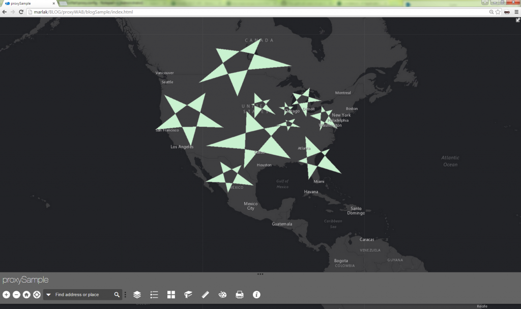

Beauty! We added the proxy rules in the config.json and configured the serverUrl in the proxy.config. Make sure to save those two files and run the application in a web browser!runApp-1024x540.png
Look at that, you’re a *S*T*A*R* ! Now you’re a pro at setting up a proxy with Web AppBuilder! Have fun creating and designing beautiful apps!starApp1-1024x607.png
