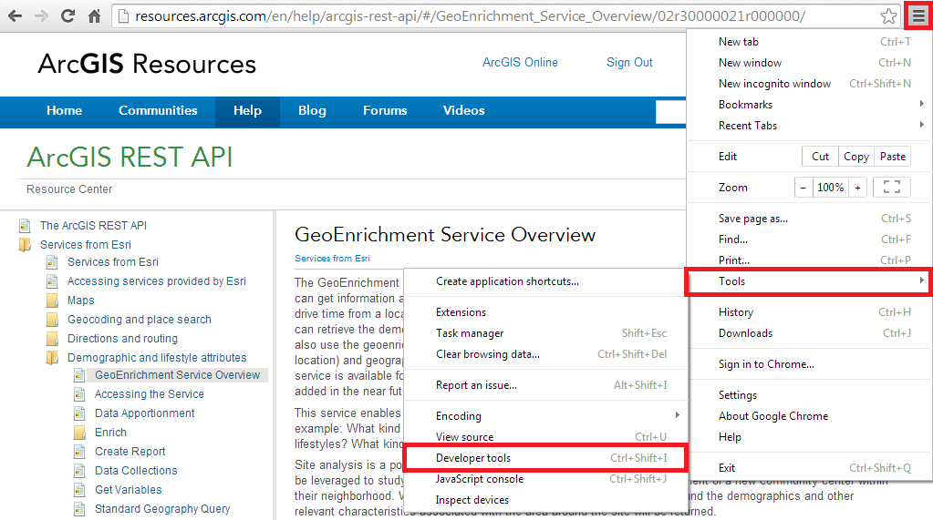

Accessing the Chrome Developer Tools is easily done using shortcut keys (Control + Shift + I) or by navigating to the top right of the browser, clicking on the three grey horizontal lines, then choosing “Tools”, then “Developer tools”.three_grey_lines4.png

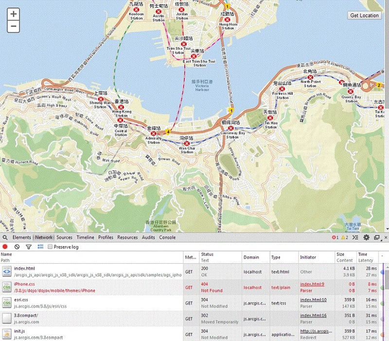

If something has gone visibly wrong in the application, the first things to look for are requests that have failed entirely.  The most common errors are a 403, indicating that you don’t have permission to access the resource, and 404, which means the resource can’t be found.  In my own experience, 404 errors are most often caused by a typo I introduced when I wrote out the location of a service, because I write code like a momma gorilla.
This screenshot shows the Network tab open with a 404 error (Not Found) in the network traffic regarding a missing .css file on the server named localhost (I put the .css in the wrong folder)
