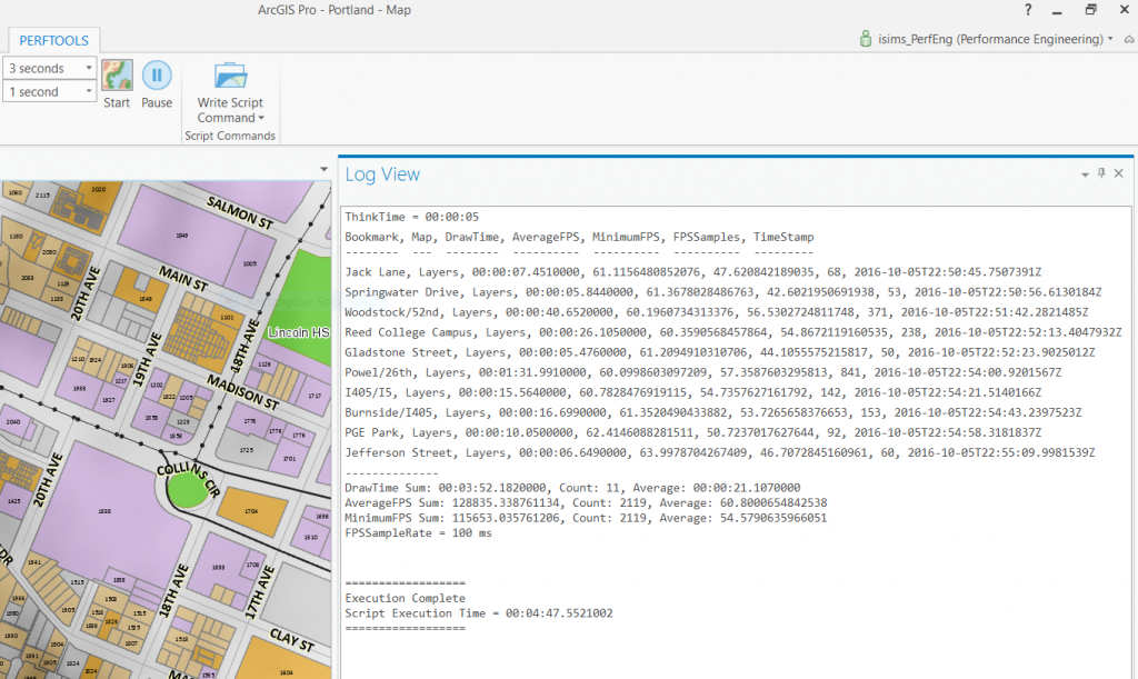

Displaying and Logging Rendering Time for Specific Spatial Extents
Have you created a series of spatial bookmarks in your ArcGIS Pro project? A one-line script command (ZoomToBookmarks all) can zoom through these spatial bookmarks and log draw time, frames per second (FPS) metrics, and other timestamps. No bookmarks?  No problem…you can also specify extents by providing 2D or 3D camera positions in the same spatial coordinates as your data. Capture_BookmarksLog-1024x611.png
