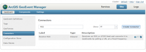

Once you are logged in to the GeoEvent Manager, click on Site > Connectors and search for “RSS”.ConnectorScreen-300x107.png

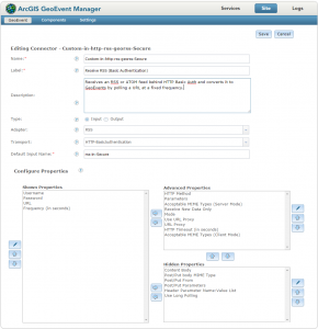

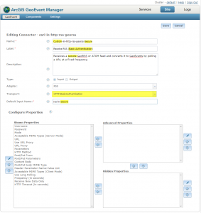

Let’s make a copy of the Receive RSS connector. Click the Copy button, and rename a few fields to ensure we don’t get mixed up later. I’ve highlighted the changes I’ve made (click the image to see the text), and if you’re following along, I recommend making these changes to simplify your use of the secure RSS connector we’re creating.CopyScreen-283x300.png

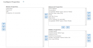

Next, we’ll configure the properties to match the original RSS feed’s properties, but since we are using basic authentication, we now have the option for a Username and Password. Let’s move the properties around a bit, hiding a few that we won’t use, and allowing for the option of configuring some more advanced ones in an organized way. Your properties should look like this when you’re done:FinishedProperties-300x156.png

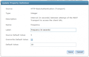

Click on Frequency (in seconds) and select the Edit button on the left-hand side of the Shown Properties box. Check the box for Overwrite Default Value, ensure the Default Value is set to 10, and click Save.Frequency-300x193.png

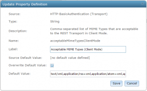

The Acceptable MIME Types, for both Server and Client Mode, will be modified the same way. Edit both properties with the Edit button closest to the Advanced Properties box, check the Overwrite Default Value box, and copy and paste the following text from the original RSS connector into the default value.
text/xml,application/rss+xml,application/atom+xml,application/xml,text/plain
It should look like this:MIMEtypes-300x186.png
Got them both done? You’re sure? These are really important. Double-check them both.  Great. We’re almost done.

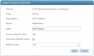

Edit the HTTP Method property. Overwrite the default value, and ensure that it is set to “Get”.HTTPMethod-300x179.png

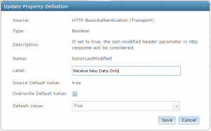

Next, update the property definition for the Receive New Data Only property, check the overwrite box, and make sure that this is set to “True”.ReceiveNewDataOnly-300x187.png

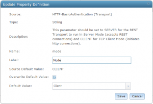

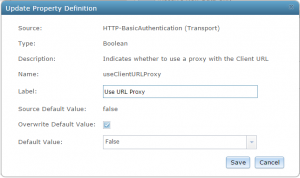

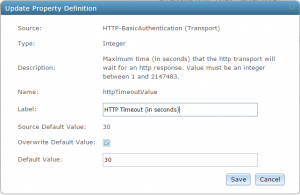

Moving on (and on…) to the Mode property, let's overwrite its default value and ensure it is set to “Client”.Mode-300x204.pngOverwrite the default value for Use URL Proxy and set the default value to False.UseURLproxy-300x178.pngDo the same for HTTP Timeout (in seconds), and set the default value to 30.HTTPtimeout-300x195.png

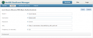

Now we can add a new Input using the Receive RSS (Basic Authentication) input connector we just created. Configure it with your login credentials and the GeoRSS feed URL.ConfigureInput-300x123.png

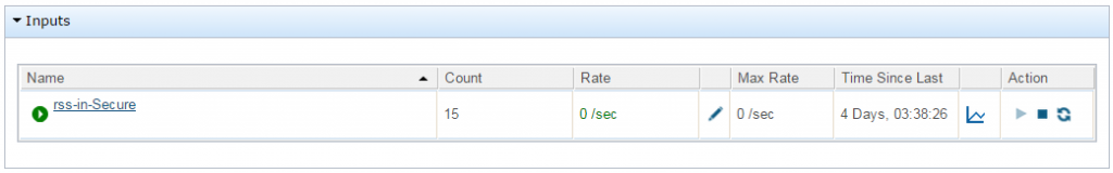

Once this is saved, you should see the count increase on the Monitor page by however many points are currently in your feed. This lets you know you have successfully logged in and started receiving input from the feed.InputMonitorPage-1024x160.png
