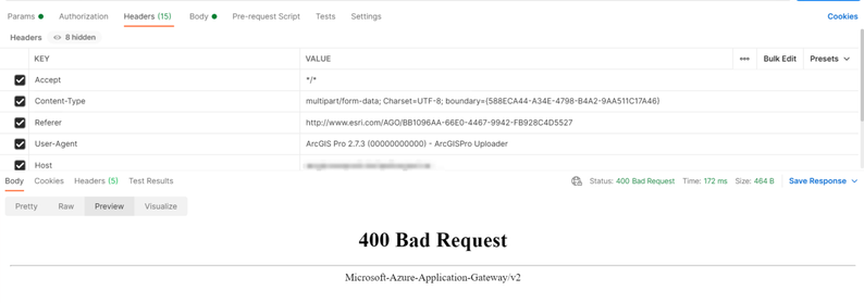

Troubleshooting this issue further we where able to capture the offending request using Fiddler and troubleshoot it using Postman to change the request. We found that the issue appears to be how ArcGIS Pro formats the boundary in the Content-Type header. The curly brackets in the boundary cause the WAF to block the request. If we removed the brackets from both the Content-Type boundary and the body of the request the WAF does not block the request and Portal for ArcGIS returns  "success":true.
This is how ArcGIS Pro formats the Content-Type request that gets blocked by the WAF:
multipart/form-data; Charset=UTF-8; boundary={588ECA44-A34E-4798-B4A2-9AA511C17A46}
This is how the WAF allows the request to go through:
multipart/form-data; charset=UTF-8; boundary=588ECA44-A34E-4798-B4A2-9AA511C17A46
