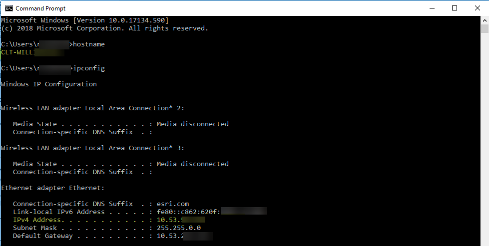

Next, if you don’t already know it, you’ll want to take note of your Windows machine hostname and IP address. You can get those details by opening a Windows console and entering the HOSTNAME and IPCONFIG commands like in the example below (details redacted to protect the innocent). These details will be used later.
Figure 1: Ipconfig and Hostname
IPCONFIG AND HOSTNAME COMMANDS

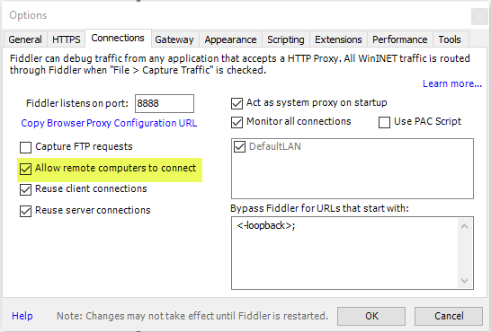

Once you have those details, open Fiddler and navigate to tools>options. Enable the option to allow remote computers to connect and keep the rest of the results.
Figure 2: Fiddler Connections options
Fiddler connection options

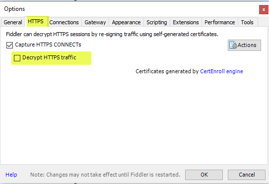

Next, click the ‘HTTPS’ tab. By default, the ‘Decrypt HTTPS traffic’ option is unchecked, but if you’ve used Fiddler to debug HTTPS traffic already, this option may be enabled.
Figure 3: Fiddler HTTPS options
fiddler https options

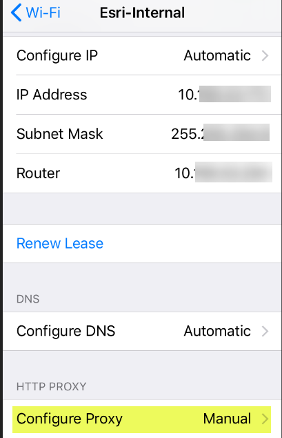

In my case, once I’ve joined the WIFI, I click on the WIFI connection and scroll down to ‘Configure Proxy’
Figure 4: WIFI proxy configuration
configure device to use proxy

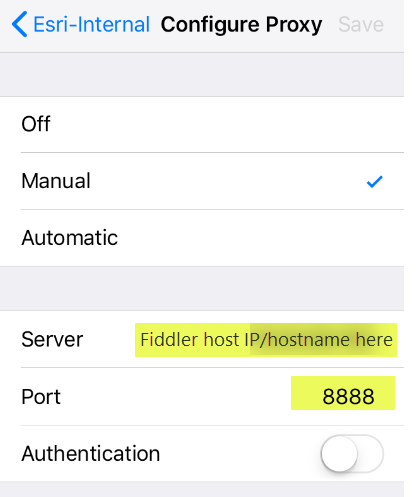

Once in the ‘Configure Proxy’ dialog, enable ‘Manual’ configuration, and populate the Server and Port settings.
Populate the ‘Server’ value with the hostname or IP address of the machine where Fiddler is running. By default, Fiddler listens on port 8888.
Figure 5: WIFI proxy configuration
device proxy config

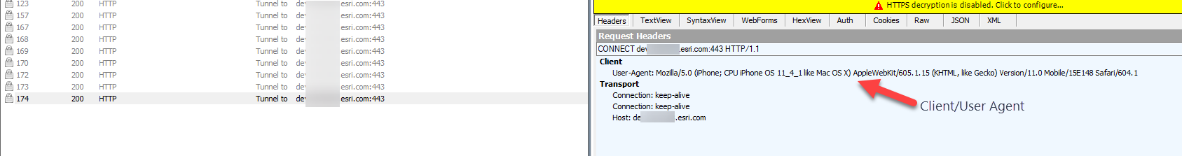

After you’ve selected a session, in Fiddler, click on the ‘Inspectors’ tab, and then the ‘Headers’ subtab. You’ll want to have a quick check to make sure that the Client is your mobile browser or app instead of a desktop browser or app. Typically Esri clients indicate “Esri” or “ArcGIS” for the user-agent.
Figure 6: Confirm user-agent in Fiddler Headers tab
review user-agent
After you’ve checked the user-agent and are sure you’re reviewing the correct traffic, click the ‘TextView’ tab. Just like before, you can review the TLS version that the client is using.
Here I’m satisfied that my iOS browser is creating sessions to my server using TLS 1.2.
Figure 7: TLS version in Fiddler TextView tab
fiddler textview tab
