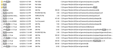

When I run the first ArcGIS server python script,  I did see the list of JAR files but I encountered permission issue in the "--delete" part.  I need to resolve the permission issue and try again.

@JohnHu The following steps should eliminate that traceback error. First stop the ArcGIS Service that you are attempting to patch (aka portal, server, or datastore), next run python 3 as admin. As a test, our team attempted to run the script without stopping the services on a dev environment just to see what would happen (against the instructions). Doing so gave us the same permission issue you are seeing. I don't believe that permission lock will release or reflect back accurately unless you also close out of python and come back in fresh after stopping said service(s). Give that a shot.
MichaelVolz
Esteemed Contributor
I was using a domain account to log into the server as an admin, but I still did not have all the permissions needed.  I needed to grant full control to the user for the folders where the files would be impacted in order for the delete script to run successfully.

Putting it out here if anyone else encounters a similar behavior - We encountered an error "that another process is using the log4j-core.2.11.jar" file when we ran the -delete command even after making sure that ArcGIS Server service and GeoEvent service were stopped. We noticed that Zookepper's JDK process was still running which was blocking the script. Once we manually killed the process, we were able to successfully run the script.
