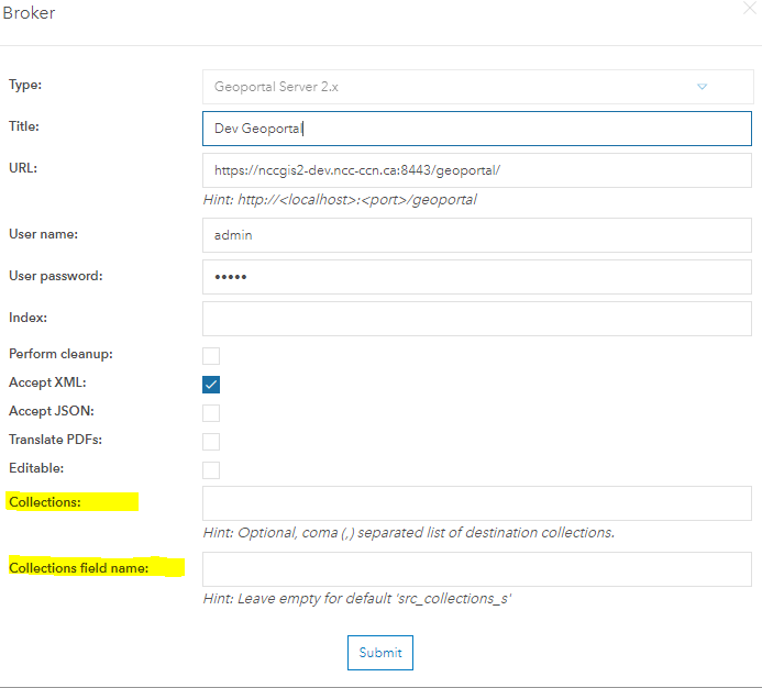

I am thinking maybe collections and collection field names would rearrange the mapping but I am not sure.
