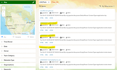

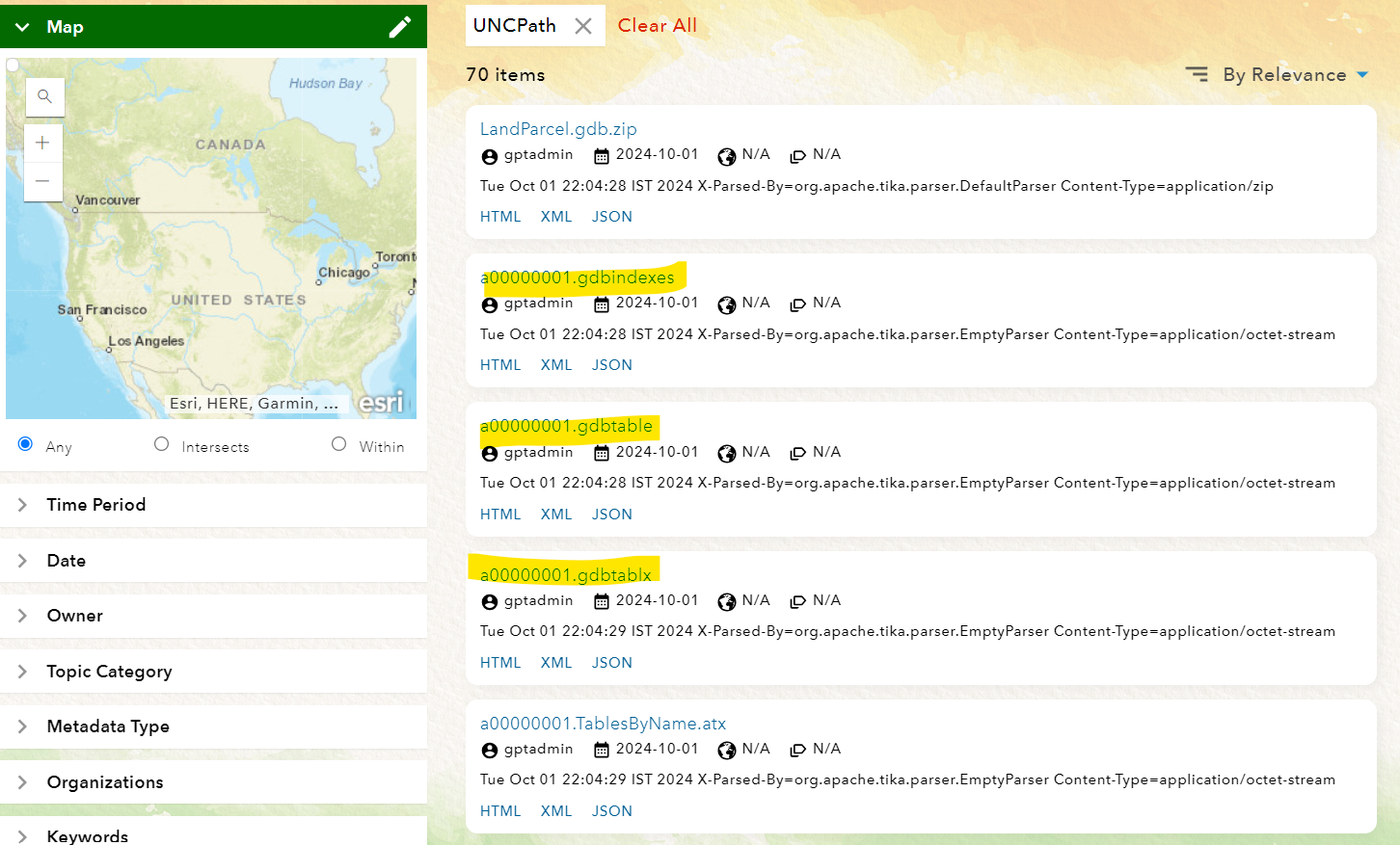

Geoportal Server has the capability to harvest data using a UNC path. However, we encountered an issue we harvest the .gdb, .mdb, and .shp files, Geoportal Server only harvests the file system only, But we wanted to harvest these datasets as GIS layers rather than just files. I’ve attached a snapshot below for your reference.

hi, that is expected behavior. In order to harvest metadata from file geodatabase or personal geodatabases, you will need to write an ArcPy script that crawls folders. Something like this:
