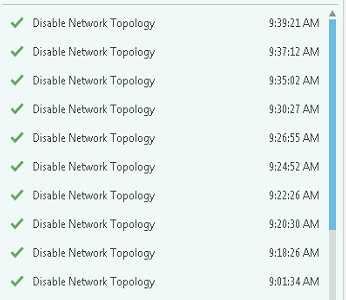

I am working with the electric asset package, and testing different configuration settings.  A big issue I am finding is the disable topology GP tool is hit and miss.  Although it always succeeds in the output message, it doesnt always actual work.

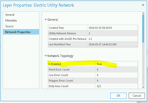

As you can see below I have run this back to back and it succeeds each time (I receive an error if topology is already disabled).  the second screen shot is after disable topology has been run.
Is this a known issue?

If you restart Pro, does the topology still show as disabled? I see the UN was created with Pro 2.2 -- have you since upgraded to Pro 2.3?
DamienPyne
Hey Paul, yes ran the standard restart and am running 2.3.2.
I have found this very hit and miss and now just run disable until it errors to tell me its already disabled.  The alternative is to prep the changes needed in whichever GP tool I need and it then fails due to topology not being disabled.  Yesterday was probably the worst example.  Normally I need to run the disable 2-4 times.
