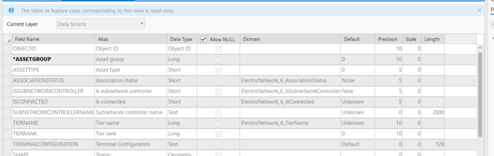

If not, could you confirm the field type and parameters of the field for the asset type field that you have configured for me, please? An example of what I need is shown in the attachment.
AiminFan1
HI BrianBerube_GIS ,
Here is the field type for asset type:
It looks like the field type is short.
Thanks
Aimin
