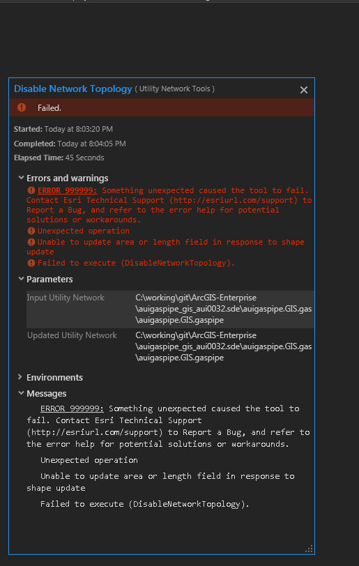

I needed to do some configuration on my Utility Network, so I ran Disable Network Topology tool. I got the error as shown below.
I rolled back to ArcPro 2.4.3 and run the same tool, everything works fine.
I suspect this could be a bug.

Yes, I tested with my DEV environment and got that error.
Our PROD Utility Network has been working great with Arc Enterprise 10.7.x & Pro 2.4.x.
