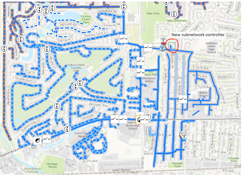

Our most recent works have been for an editing to create a new network and tie this into the existing dataset (new subsource and open an existing switch).  The user created the new network and opened the switch without issue.  When they have run the update subnetworks GP the subnetlines feature creates but the subnetwork name attribute stops along the feeder, conflicting with the subnetwork line.
This has been repeated by this user in a separate version.
The red circle shows where the new subnetwork controller has been created, and the updated subnetline feature is the white outline on the network to the right (shown clearer in image 2)

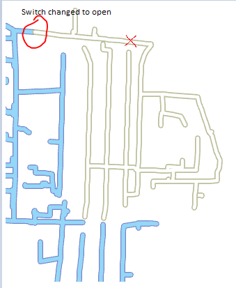

This shows the updated subnetlines, and the location of the opened switch.
Feeder id (subnetwork name) attribute not updated on the electric lines as shown below.  This location is shown about with an "X" in the image above.
