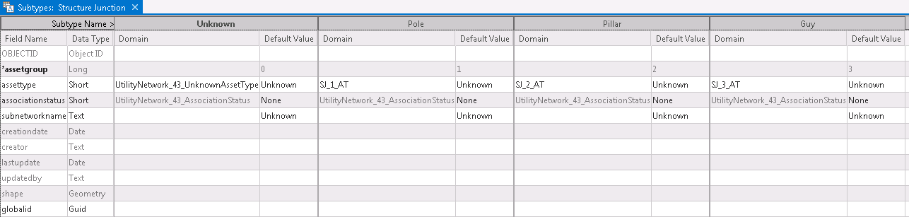

A few small modification were made to the exported asset package (file geodatabase) by adding 3 coded domains & 3 subtypes to StructureJunction feature class. The 3 coded domains were then associated to their respective subtype.
Another eneterprise geodatabase was setup and I started the steps to apply this asset package
'Stage the Utility Network' was successful but 'Apply Asset Package' generated the error below.

0 None None None StructureJunction/Pole | StructureLine/Pole Domains assigned to field 'AssetType' must not be shared error
1 None None None StructureJunction/Pillar | StructureLine/Pillar Domains assigned to field 'AssetType' must not be shared error
2 None None None StructureJunction/Guy | StructureLine/Guy Domains assigned to field 'AssetType' must not be shared error

Anytime you get the "The asset package has the following errors:" message, that means there is something incompatible in the asset package and so execution is halted.
For this particular error, you are sharing the same asset type domain between the StructureJunction and StructureLine classes, which is not allowed. This error only checks asset type, so you can freely share other domains as much as you want.
As for why this is blocked, it's because you can modify a domain and it unintentionally has an impact on other asset types.

AnthonyRyanEQL
Paul,
Sorry to have wated your time with this.
I didn't even realised I had configured StructureLine thinking it was StructureJunction.
