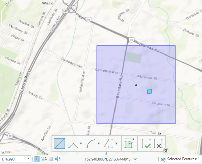

With ArcGIS Pro 2.5 there is a setting <MinimalDirtyAreaSize> in the enterprise geodatabase which allows the size of dirty areas around points to be set to a fraction of a coordinate system linear unit, at the moment I have only been able to set this via SQL.  Following is the result of this having the value <MinimalDirtyAreaSize>0.01</MinimalDirtyAreaSize> (dirty area size 0.01 degrees square around an edited point).Dirty area size 0.01 degrees square around an edited point

Will,
Is there any limit on how far the scale can be? In your example of 0.01 decimal degree, this would be approx. 1 sq kilometre. I would be thinking of 1 sq metre (similar to 1 sq feet in Naperville demo data) so the factor would need to be around 0.00001. Good work on the testing so far.

WillBooth1
Hi Anthony,
Here is the result from <MinimalDirtyAreaSize>0.00001</MinimalDirtyAreaSize>
dirty area size 0.00001 degrees square around an edited point
Cheers
Will
AnthonyRyanEQL
Will,
Thank you for testing this. We just need the MBR geometry changed to a buffer geometry and everything will be great
