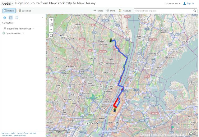

All three of these terms refer to a web map dynamically stored in the cloud, or a remote server, so that the map user can interact with it in various ways.  By "interact", I mean change the scale, extent, classification, or symbology, add or subtract data, filter data, analyze spatial relationships, and more.  Depending on your goals, you may want to create and use one or all three of these types of maps.  The way that maps are created and stored in the ArcGIS Online cloud to begin with is via a web map.  Let me illustrate with an example showing a bicycling trip I took from New York City to New Jersey following one of the Association of American Geographers conferences.  Upon the completion of my trip, I created a web map in ArcGIS Online showing my bicycling route, which I captured using a GPS device that I carried with me.  I recorded my route as a track, and I added that track as a GPX file to ArcGIS Online.  I saved the resulting map as a standard ArcGIS Online web map, which I shared with everyone so that can look at it as well, in the link above and shown below.
Bicycle Route, New York City to New Jersey, shown in ArcGIS Online.

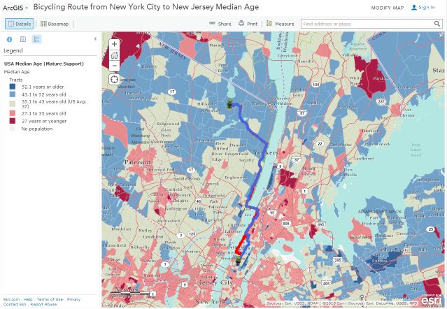

Users of your ArcGIS Online maps will not only be able to access your map as you have created it, but they can also save it into their own ArcGIS Online account and make changes to it.  For example, I started with the map above and wanted to analyze the median age along my route.  I easily added that layer to it and saved it as a new map.
Bicycling Route from New York City to New Jersey with Median Age.

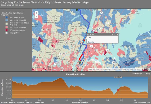

But now let's say I want to create a map with multiple panels, each showing a different map theme, or a map showing a 3D profile of my bicycling route.  This is where web apps come in.  A web app is an application, and ArcGIS Online provides a number of useful web app templates that you can use, or you can configure your own.  I think of it this way:  If you want your map user to have access to the full array of ArcGIS Online tools, publish your map as an ArcGIS Online web map.  But if you want specific tools and functions to be available to your users, and you don't want them to be distracted by the other tools and functions in ArcGIS Online, then publish your map as a web app.  How can you do this?  When you are saving your map, simply indicate that you wish to publish to a web app, and you will be presented with a list of options.
To illustrate a web app, I created a web app from my ArcGIS Online map to show the 3D profile of my cycling route along with the median a....
New York City to New Jersey elevation profile, with median age, web app.

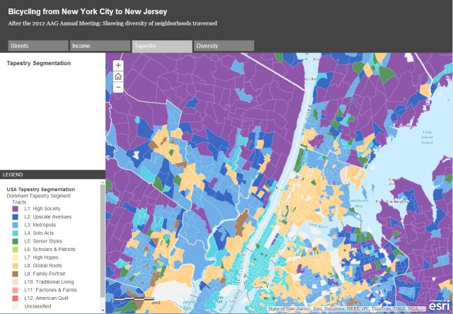

Story maps, about which we frequently write in this blog because of their great utility in education, are simply a specific type of web apps.  A whole set of story map apps exist to choose from.  One type of story map is a storytelling text and legend. which I used to create the story of my experience, with tabs indicating streets with my cycling route, income, tapestry lif....
Bicycling Route from New York City to New Jersey as a storymap web app.
