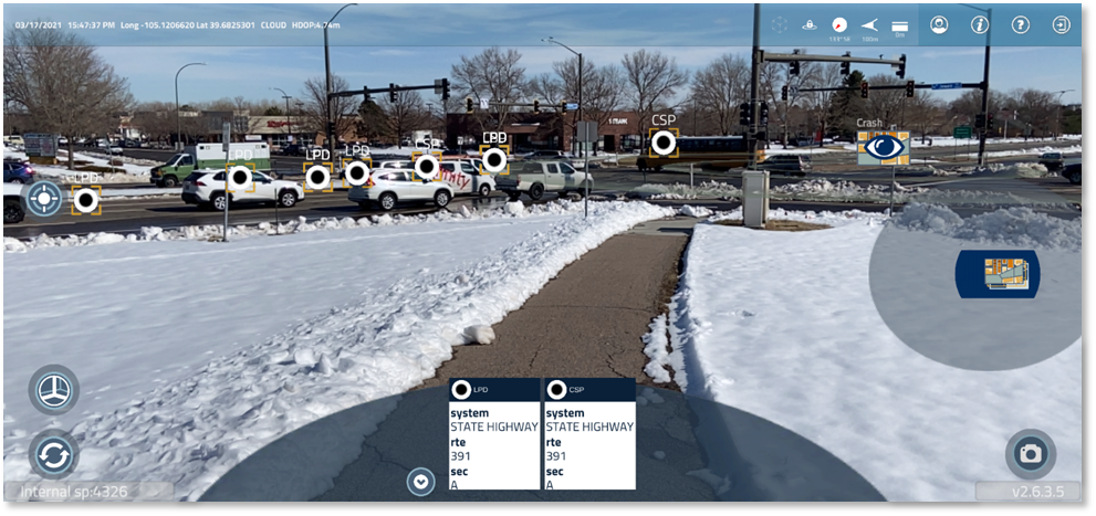

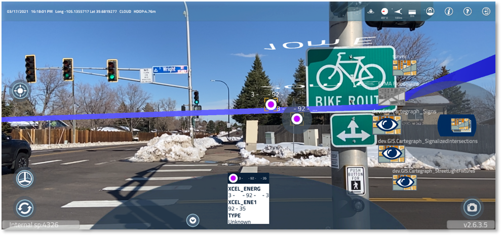

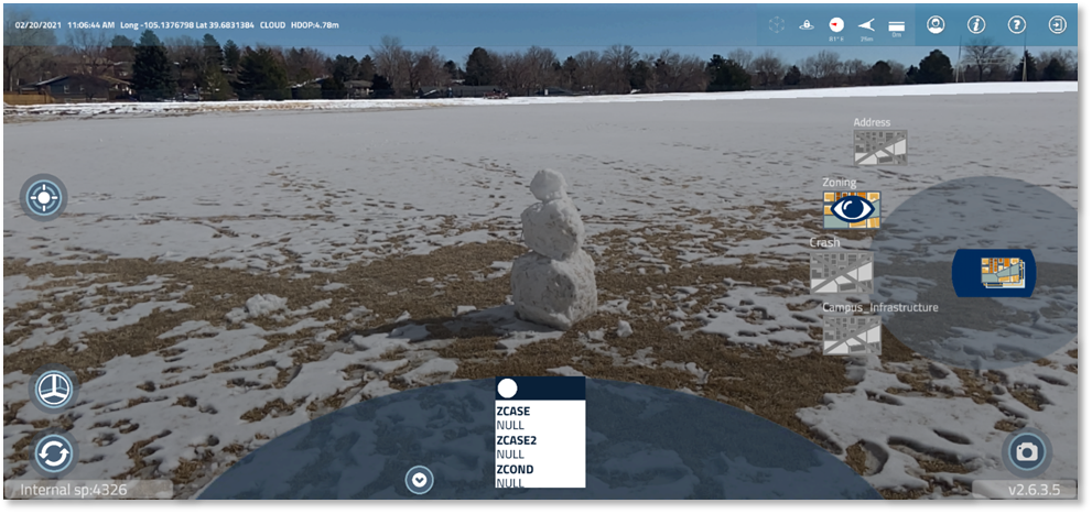

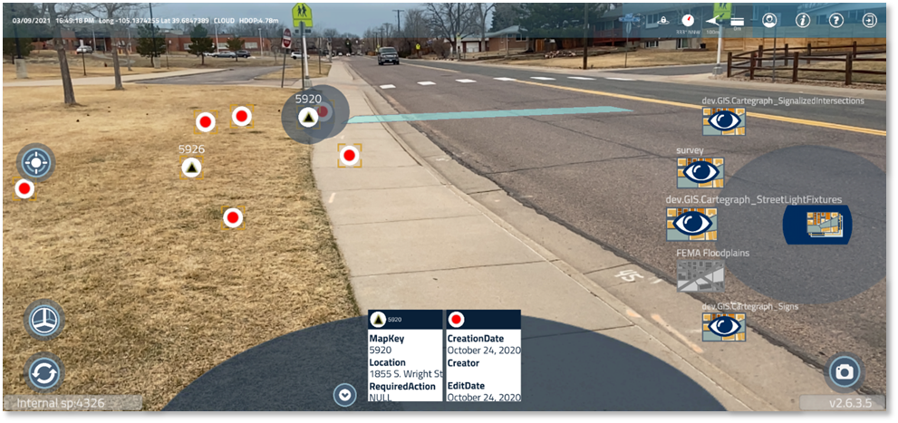

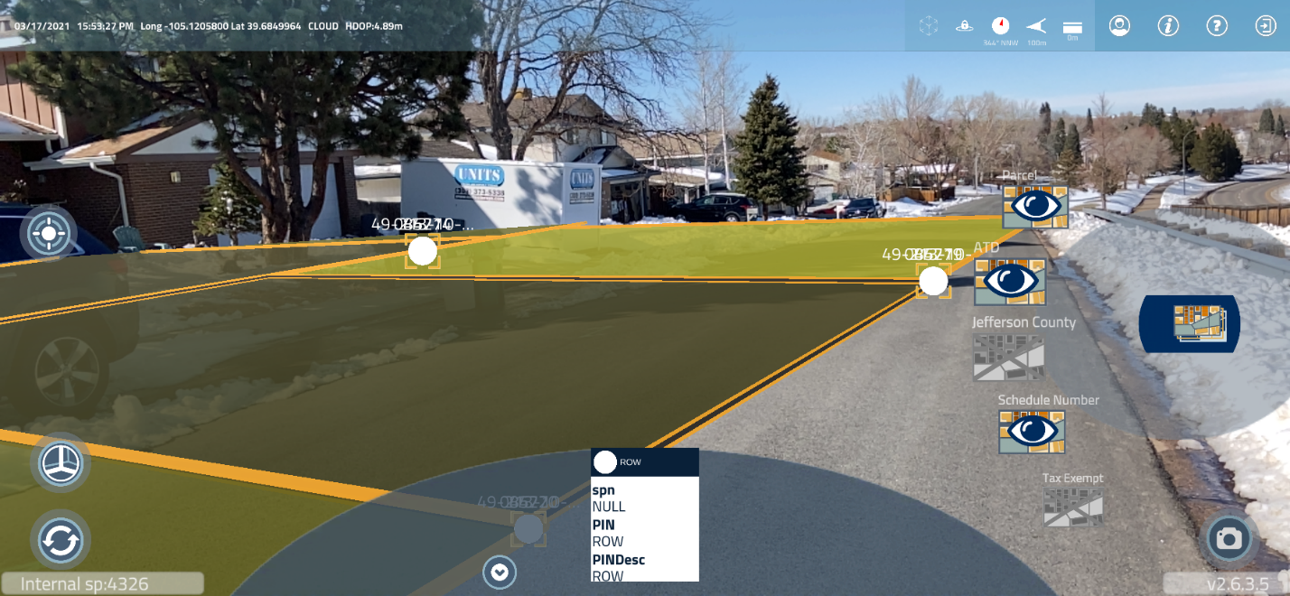

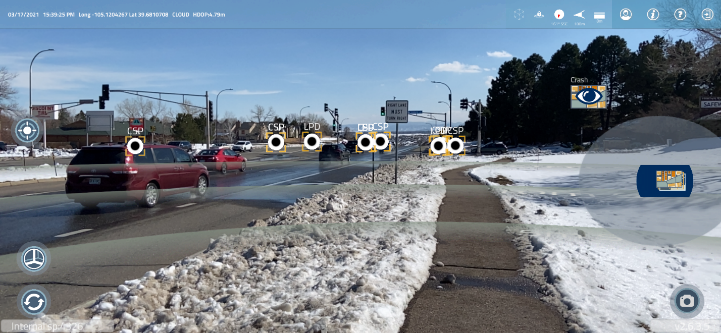

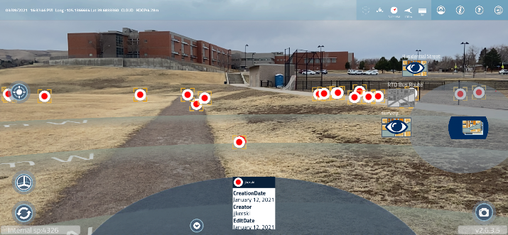

Since all of us in geospatial technology love visuals, the best way to help you understand what the Argis Lens does is to compare these two pictures that I captured below on a school campus.   What are the differences between the left and the right picture?
The picture at right gives me the attributes of the features that I see on the ground on the school campus!

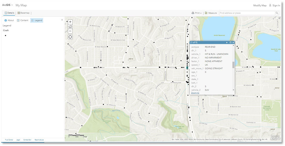

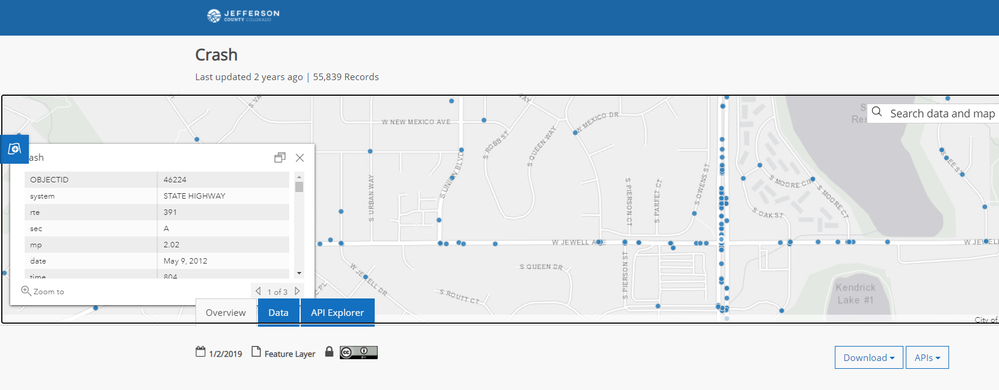

How is this possible? Consider the following:  We are all familiar with examining data on maps using GIS tools, such as this accident data over a span of a few decades, shown below in ArcGIS Online:
But what if you could be on the ground, inside your study area on the above map, and just with an ordinary smartphone, examine that same data, seeing exactly where that data or phenomenon occurred?   Below is a screen shot from the Argis Lens app on my phone, after I walked to the intersection that I was examining above.  Here I am examining the accident data, at the locations where the accidents occurred!  Each point shown in the image represents an accident, and inside the boxes at the bottom of the image are the attributes.

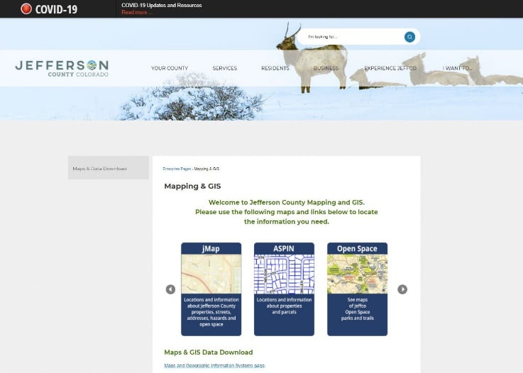

(2) Find GIS data to be viewed with augmented reality (AR) as a feature service.   Since you will be in the field examining this data, you will need to go to your local city, county, or other organization who might be hosting data in the public domain that covers the area in which you will be working.   Since you will likely be accessing your study area on foot, choose layers that have a fairly high density of coverage in that study area.  Otherwise, you will be walking hundreds of meters or more between each feature, which will add to the time required to examine the data and to teach the concepts that you wish to teach.
How can you find these data layers?  Fortunately, we are firmly in the era of data-as-services, which are becoming more and more common as communities realize the value of open data that allow people to make wise decisions.  See my detailed guidance below these steps.

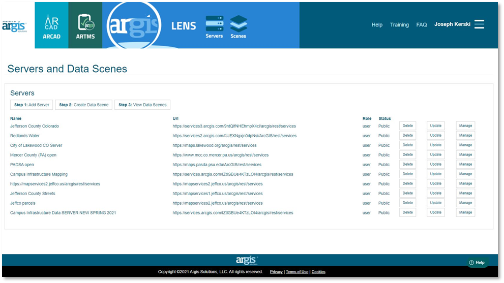

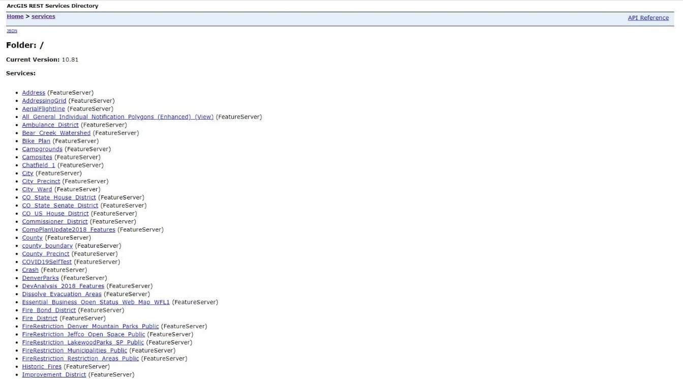

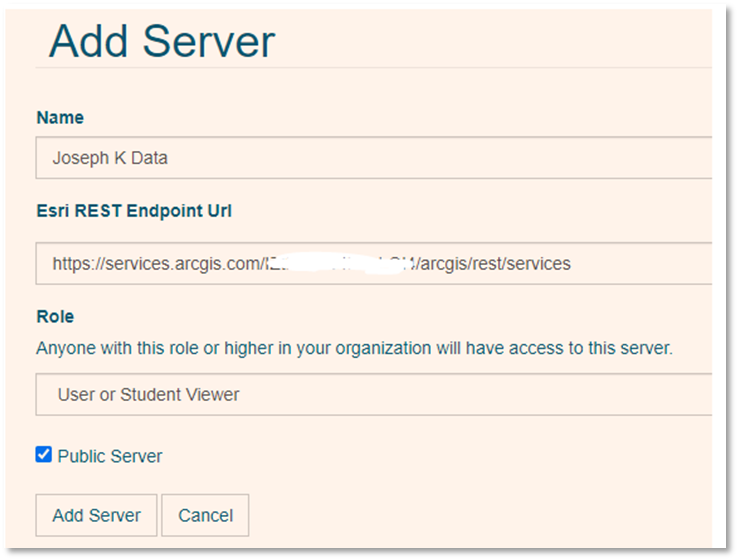

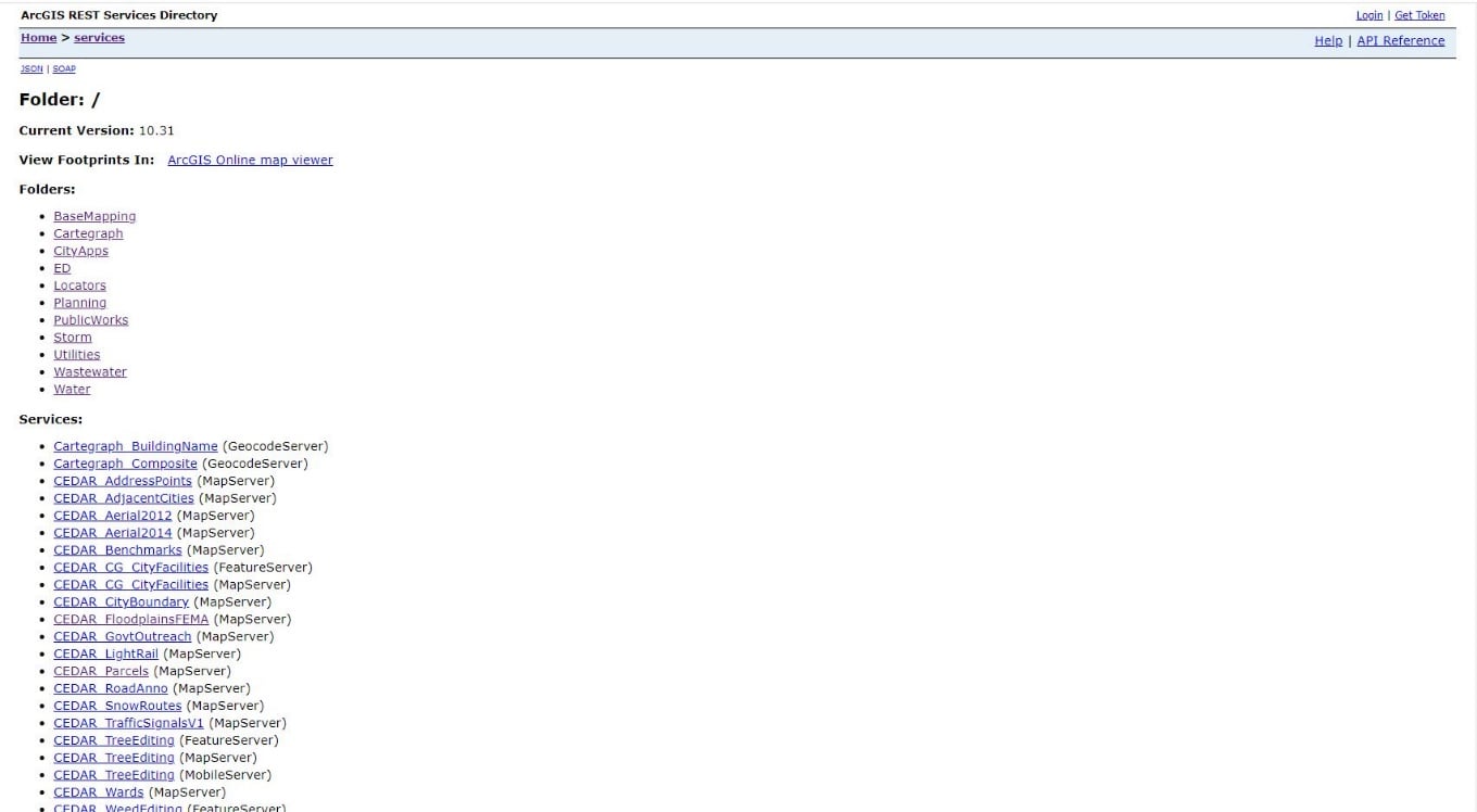

(3) Log in to the Argis Console to create a list of servers that are housing the data that you choose to examine.  Enter the REST Endpoint URL into the Argis Console to securely access this data.  My servers are mostly from my own city government and my county government’s open data portals.   Yours will cover different areas of interest but the idea is the same—find data providers that host data covering your study area.  I recommend focusing on point data, such as light poles and storm drains, but include at least one line layer (such as streets), and at least one polygon (such as ponds, or parcels).

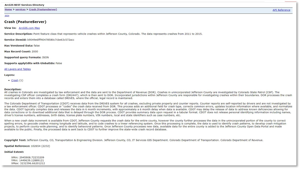

To find the REST endpoint requires a bit of digging:  You typically need to go beyond the data portal’s front page to the list of data layers.  For example, Jefferson County Colorado’s front GIS data pages look like this:

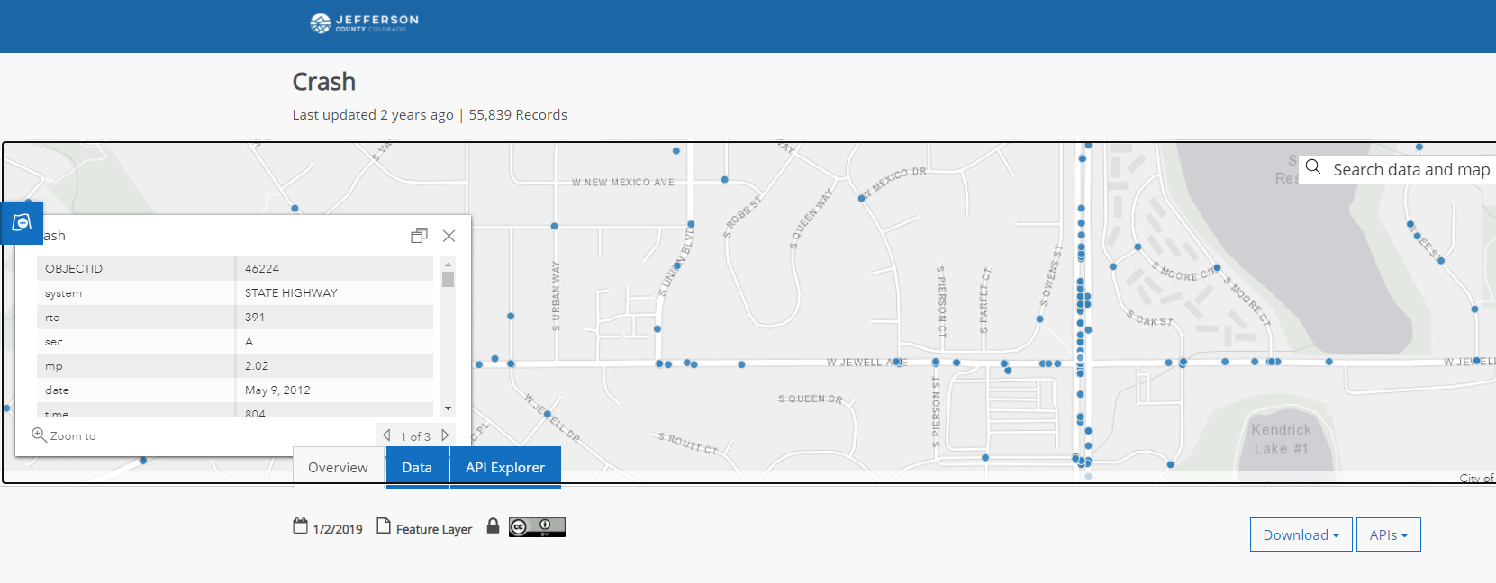

But if you dig deeper, you will find metadata pages like the ones shown below where you can obtain the REST endpoint address of the layers.  Your goal is here is that you don’t want PDFs, or online mapping applications, but rather, the feature service addresses themselves.  This is what can be mapped in ArcGIS Online, ArcGIS Pro, other GIS software, as well as the Argis Lens.  Shown below is just a fraction of the layers available from my own local city and county government agencies (thank you, folks!).  These include trails, parcels, fire districts, light poles, storm drains, traffic accidents, and much more.  Choose carefully, keeping in mind issues of bandwidth and pulling up these layers on a phone in the field.  More is not always better!  The URLs for the layers that you are seeking can be obtained from these pages.
For example, here is the layer for one of the layers I am interested in examining, the motor vehicle accidents layer (named, appropriately, “crash”).   The metadata for the layers will help you choose which layers that might meet your needs.
The REST endpoint of my own data layers came from my own ArcGIS Online organization’s server.   I entered this REST endpoint in the Argis Console through the Add Server function as follows:

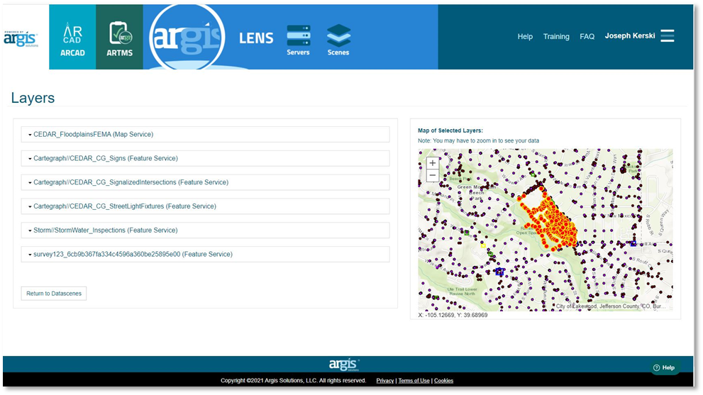

When done, make sure you can view the list of your servers in the Argis Console, as I show below:

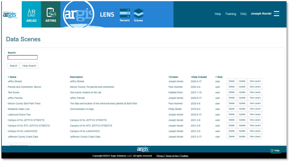

JosephKerski_6-1619279106305.png(4) Once you have created a list of servers from which you will obtain data from, create and build at least one Argis data scene.  A data scene is what the Argis mobile app uses when you are in the field:  You will be viewing a data scene.  As you create data scenes, you will assign viewing privileges for your field users (students and other instructors).
A view of one of my data scenes is shown below.  You know you are on the right track if you can zoom to your study area and see features there, such as my assortment of signs, traffic lights, and storm sewers.
You can set up more than one data scene.  In my case, I created several data scenes, one for a few things in the built environment, such as light poles, signs, and storm drains, one for the accident data, and one combining my own data with data that local governments had created.  Some are shown below.

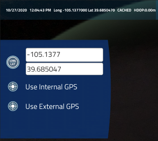

(5) Before you go into the field, test to make sure your data layers will be visible once you are there.  To do so, adjust your “current” coordinates by clicking on the Location button on the app’s left side and entering the longitude/latitude of a point inside your study area.  One easy way to determine a suitable latitude-longitude point is to open up ArcGIS Online (www.arcgis.com), panning and zooming to your study area, and using the position location tool under the measurement functions and taking note of that latitude and longitude.  Enter these values as shown below.
(6) Now you are ready to go into the field!  Once there, you will pull up the Argis Lens app and view your desired data scenes.   More extensive help exists on the Argis website, but in brief:  On the Argis Lens app’s interface, you will see the layers that you have loaded in your scene at the right, with the layers currently visible with the “eye” symbol, as shown below.    As you walk the landscape, you will see the points, lines, and polygons appear as you approach them.  In the image below, you see one polygon and a set of points as red dots.   You can set the tolerance of when they appear, such as “show when I am closer than 75 meters from the object.”
While in the field, ask your students about the patterns that they notice about the features you are analyzing, why and how such features are maintained in the field, and by whom (say, the light poles vs the storm drains), and the advantage to your government agency or other data provider to map and maintain all of these features in the first place.  Include some of the teachable moments that I describe below, such as about spatial accuracy and attribute completeness.

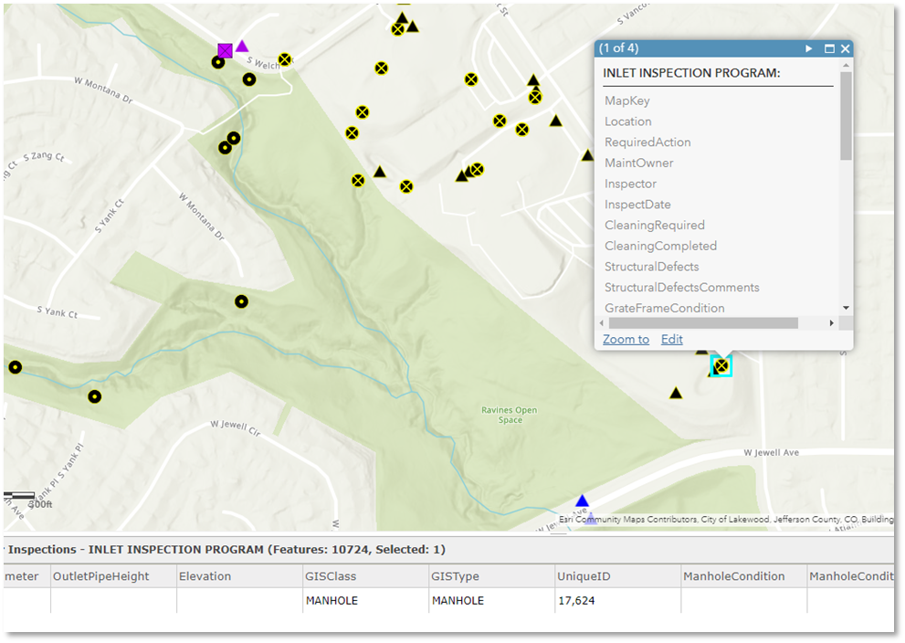

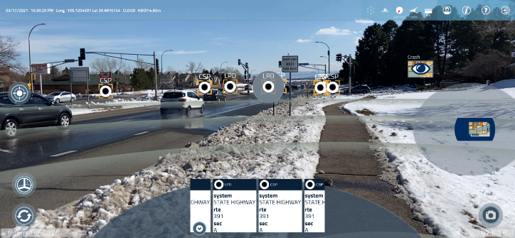

On the app, you can select by clicking on any of the features, and their attributes will appear.  Below, for example, I see point data for accidents (on left), and I can click on each of them to obtain their attributes (right).
I recommend that you examine some point, some line, and some polygon features to foster geospatial literacy and to keep things interesting!  In the scene below, the traffic signals are points, and the streets are the thick blue lines.

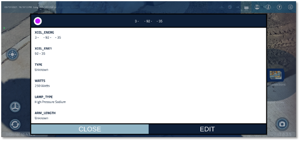

Selecting the light pole reveals the attribute table, part of which is shown below, including the owner (Xcel Energy), watts, type of light fixture, and more.
How can I find local data for my study area?

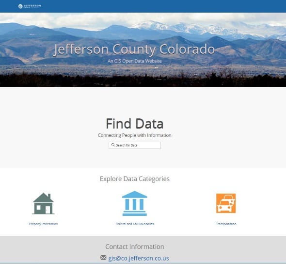

Thanks to the open data movement and the advancement of data sharing formats and standards, a growing number of portals and servers exist containing spatial data.   These layers are often easily ingested into ArcGIS Online and hence, the Argis Lens.  Where can you find these data portals?  Start with my guidelines, Modern Strategies for Finding Geospatial DataIn short, the Living Atlas of the World is an excellent starting point (https://livingatlas.arcgis.com),  Many of these portals use ArcGIS Hub technology, and searching these hubs is another fruitful method.  Another method is to search on <your city or county or your community or region’s name> plus the phrase “open GIS data” or “open data portal” or “GIS Department”.  Our Spatial Reserves data blog also provides essays that can be used for discussing related societal issues such as location privacy, spatial accuracy, and the pros and cons of charging a fee for data.  An increasing number of these data portals allow you to visually inspect the data on web maps to help you decide whether or not you want to use the map or map layer.  For example, while I liked the idea of using the floodplains layer in my own county (below), I could not use it in my study because it did not overlap with my study area.   But it would be useful for other areas in my region.
My county has a ArcGIS Hub here and my city also hosts GIS REST services.   Did they have everything I wanted?  No; I wanted a tree layer, for example.  But there was enough data here for me to use.  One useful layer is the traffic signals, especially relevant to route and slow traffic around schools and university campuses:

Examining traffic accidents is not only interesting to students, but can connect well with drivers’ education programs in secondary schools along with alcohol awareness and prevention efforts, and at the university level, connects well with community safety and criminal justice programs.  I can ask students:  How many accidents are in the database?  Does this number surprise you?  My county alone had 55,839 in the database, spanning only a 5 year period; therefore, over 30 accidents occur on average, daily.  What is the pattern of these accidents over space, time of day, day of the week?  My study area contained several accidents near the school campus and especially down the street along the north-south state highway (below).

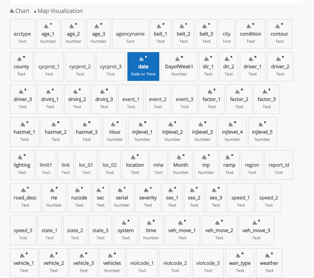

You can also, through many of these portals, see the attributes available for each layer.  In the case of the accidents data, plenty of attributes exist, including the weather at the time of the accident, time of day, day of the week, how many vehicles and injuries were involved, whether anyone was impaired, age and gender of those involved, and much more, as shown below.  Investigating and understanding these data layers is an important step in the decision-making process.

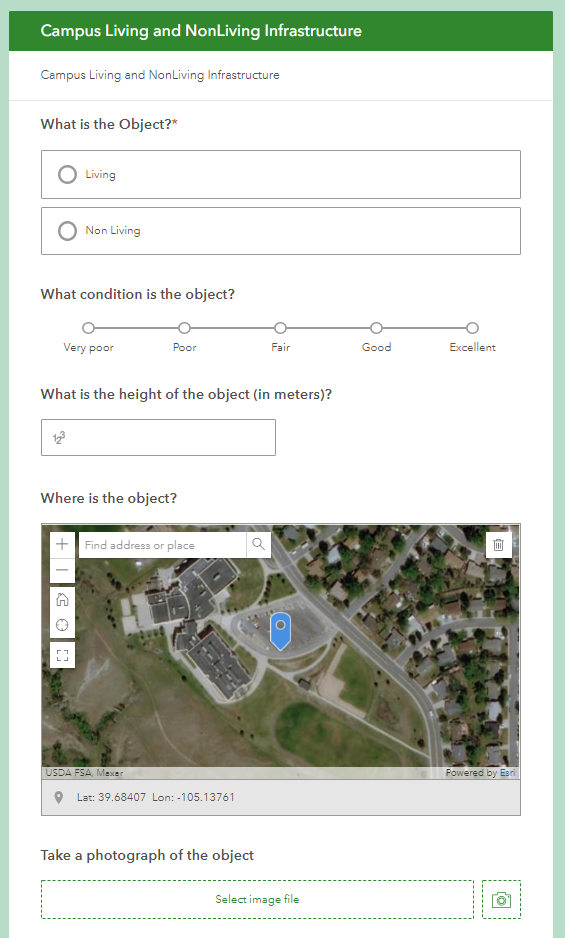

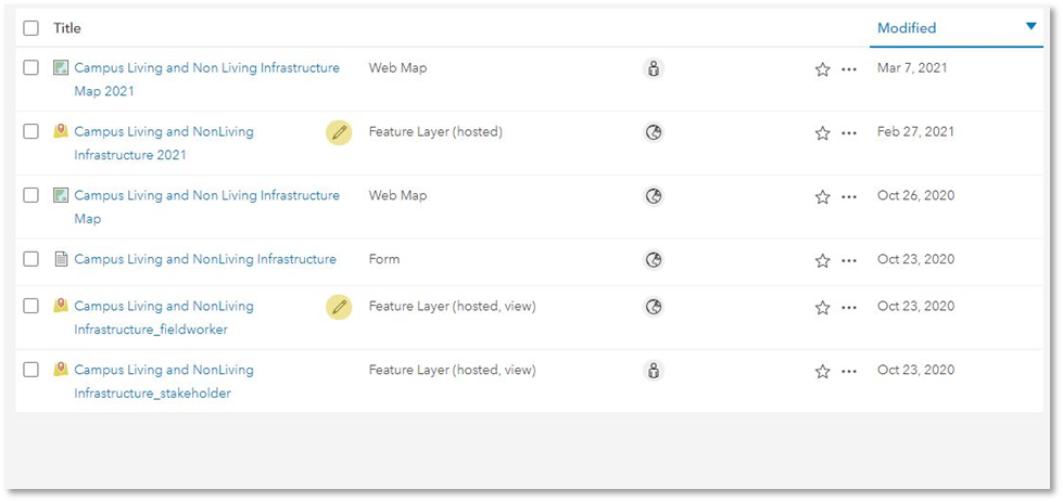

The easiest and most straightforward way to add your own data is with Survey123.   Survey123 is a field data collection tool from my organization (Esri) that allows you to quickly set up, gather data into, and map and analyze the results (hence the “123” part of the name).  In my example, I set up a Survey123 to collect point features on a campus, such as trees, recycling bins and trash cans, parking bumpers, fences, and other objects.   These are easily observed and collected on any campus.  Decide what attributes about your points you would like to collect.   In my surveys, I find it instructive to include one attribute that is a number (such as a height, a temperature, a circumference or something else), one attribute that can be ranked on a Likert scale (such as condition ranging from very poor to excellent), along with some nominal data such as type of feature.
My survey, located here (https://arcg.is/0eHOLe), contains 5 questions.  Once a person answers the “living/non-living” question, the survey expands to ask “what type of living” or “what type of nonliving” object is it?  … with a small list of choices to pick from (tree, shrub, flower, for living) (light pole, sign, fence, electrical box, parking object, for nonliving), with the last option under each, for “other”.
Once my survey was constructed, tested, and shared, I wrote down the URL for the survey.  I then went into the field with the Survey123 app on my phone and collected my desired features, answering the survey questions so that the attributes would be attached to each feature.  I took a photograph of each feature, and while I was filling out the survey, my ground position was being recorded and mapped. The resulting feature layer is named Campus Living and NonLiving Infrastructure.  Next, I set up a map in ArcGIS Online so I could see my point features.  The resulting layers, survey, and map in my ArcGIS Online organization are shown below.  Of course, a better workflow instead of you, the instructor, collecting data into the survey, would be to have your students do this!

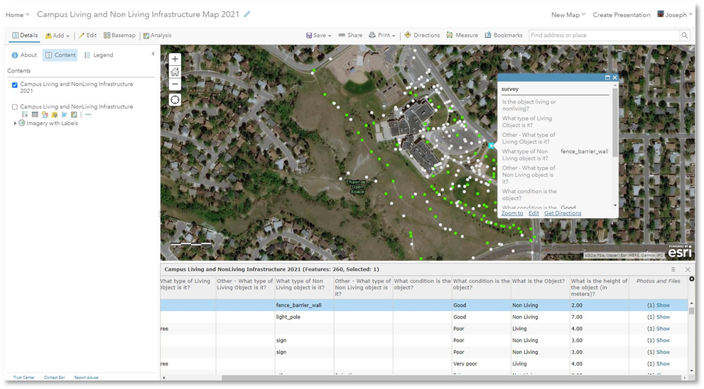

Below is a map of my collected points on the campus.   I got a little excited and collected over 250 points, but you’ll be fine as long as you collect more than just a few points.  :- )  Each of my points contains 6 attributes:  Living or nonliving, type of object, condition (from very poor to excellent), the height (in meters) of the object, position (collected automatically), and photograph.  I recommend starting with points, and as you become more familiar with these tools, include lines (such as sidewalks, powerlines, and the running track at the fieldhouse or stadium), and polygons (such as buildings, parking lots, football field, and so on).

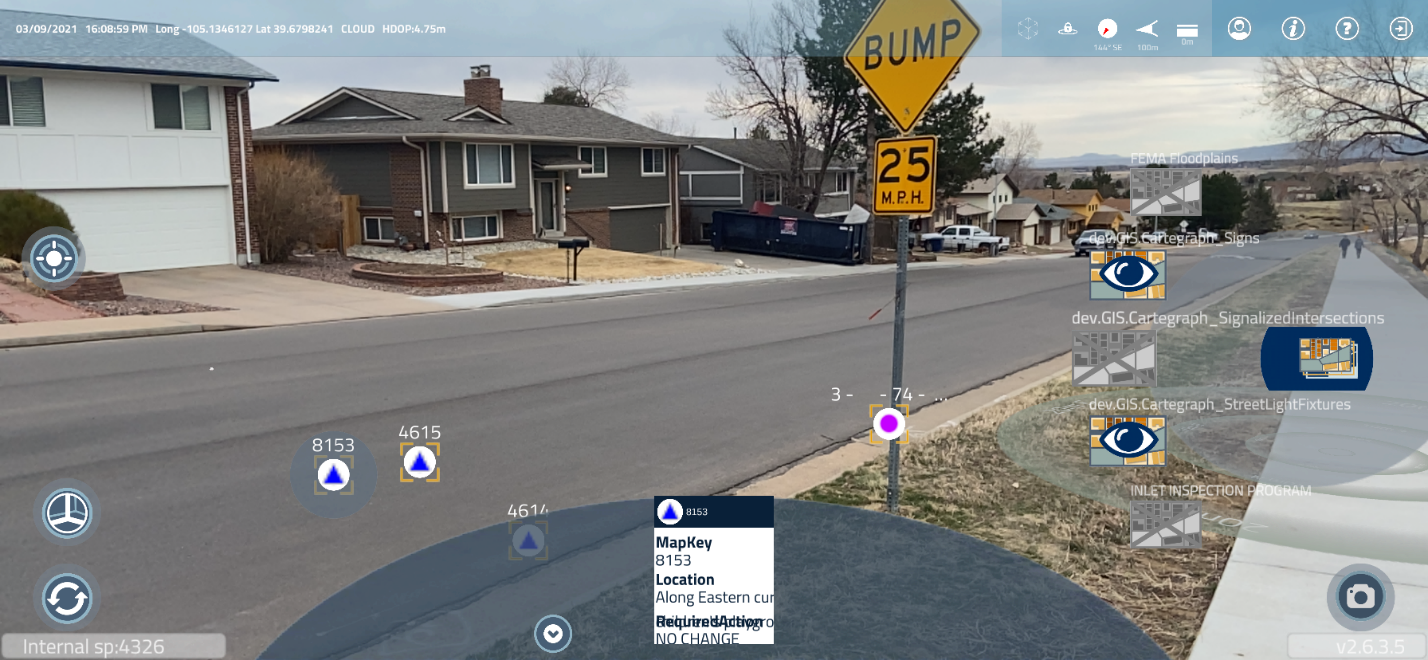

1.  Spatial accuracy.  Notice above where I said you are “seeing exactly where that data or phenomenon occurred.”  Well, most likely, not exactly.  The spatial accuracy of the positions that I was examining, and that you will likely examine, depend on several factors.  First, the GPS accuracy of a smartphone is nowhere near as accurate as those collected with a high end GPS receiver.   I can sometimes get within 2 meters of what I consider to be my “true” latitude and longitude, as based on a satellite image (which themselves are only representations of reality and have their own tolerances), but with a Topcon, Trimble, Leica, or other survey-grade equipment, sub-centimeter accuracy is possible.  Second, the features that I was examining, and that you will likely examine, such as the light poles, accidents, and storm drains, were collected by different crews, in different conditions, and with different equipment.  The accident positions, for example, might be collected with an ordinary smartphone in the field by the police officers or sheriffs.  Some storm drains might have been collected by a field worker marking a paper map with a pen 25 years ago and then digitized, with a consumer-grade GPS 20 years ago, and with a survey-grade GPS in more recent years.
Even so, you may be surprised by the spatial accuracy of some features; see below.   The point feature representing the “Bump – 25 mph” sign is actually sitting right on the sign post!

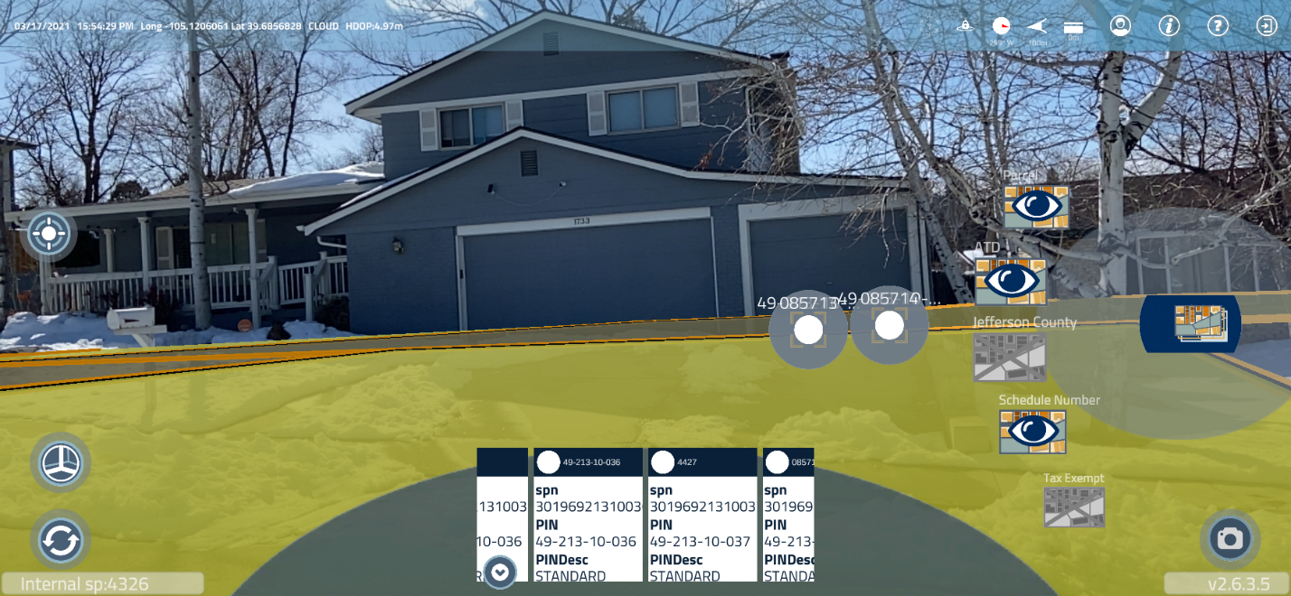

3.  Public information.  What information is public, and what is not?  In most communities, land ownership is public information.  I loaded my county’s parcel layer from the assessor’s office into an Argis scene, and lo and behold, as I walked the landscape, could view all sorts of information about who owned each parcel, when it was purchased, and other information about it.  I tested it with my very own residence (which is not shown below, but others are shown).  This is already available by visiting the GIS layers on city and county data servers, but seeing it in the field as you are walking by vacant lots, schools, businesses, and houses somehow makes these discussions all the more relevant and timely.  Who decides what information should be public?  How does this information improve decision making? How might some object to certain information being public?  How does information access vary among countries of the world, and why?  How does changing technology and societal needs influence information policies?
