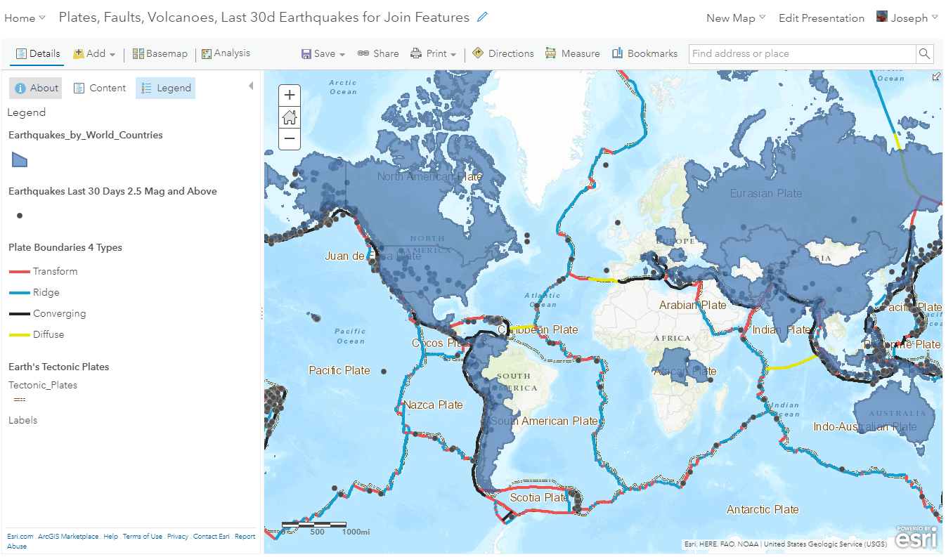

To begin, I start with my web map:
http://denverro.maps.arcgis.com/home/webmap/viewer.html?webmap=63a6261d7afa48878a52a4c7127f624e - the
Earthquakes starting point map.  It contains data layers that are streaming from the USGS earthquake center, in my case, the last 30 days of earthquakes.

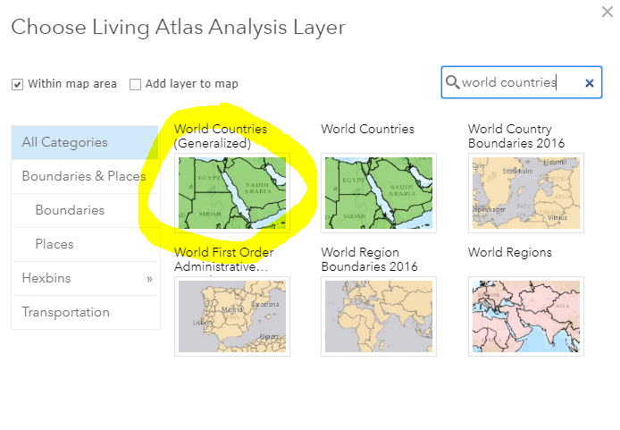

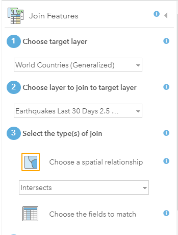

Once the Join Features analysis tool is engaged, I find World Countries (generalized) in the Living Atlas of the World.  This is my target layer, so named because my goal or "target" is to create a choropleth map by country polygons.  The layer to join to these polygons is my earthquakes layer that is streaming from USGS.  My type of join is "intersect"--if an earthquake is inside or "intersects" the country polygon, I want it to be considered.
Spatial Join 2
Here is how I found the Living Atlas content, after searching on World Countries, I selected the generalized data set:

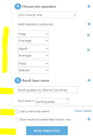

I filled in the remainder of the Join Features dialog box as follows:  I chose the one to one operation; I added statistics so I could determine average magnitude and depth by country, which I thought would be interesting (always be curious! This drives you forward in your use of GIS as I explain in this video); I named my resulting layer and I unchecked "use current map extent" just in case my current extent happened to be cutting off any outlying islands in the South Pacific, for example, and then > Run Analysis:
Spatial Join 3
My results are below, with all countries defaulting as single symbol.
Spatial Join 4

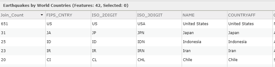

I will change the style shortly, but before I do, let's examine the new table of data.  The "join count" field contains the number of earthquakes by country:
Spatial Join 5

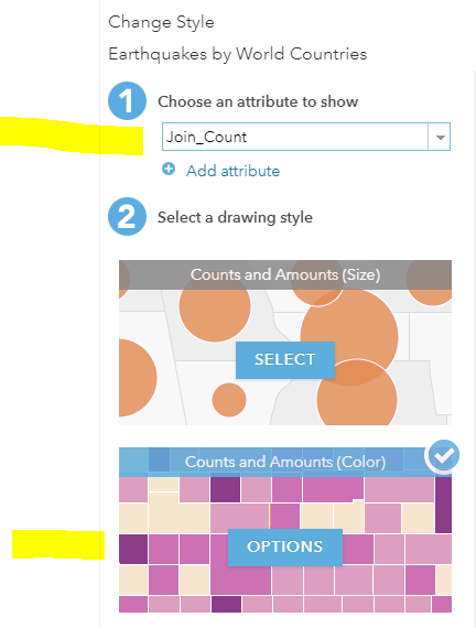

Next, I used Change Style to symbolize the countries on Join_Count, as follows:
Spatial Join 7
Because the USA contains so many earthquakes, the default Counts and Amounts symbology lumps most countries into one category.  The reason why is in part because the USGS earthquake center is in the USA.  It is in Golden Colorado; I used to give tours there as a USGS employee; a fascinating place that I recommend highly for you to take a tour in next time you're in Colorado.  The earthquake center receives transmitted signals of information from the global seismic network, but it also senses ground motion from nearby earthquakes in the western USA.  So, it senses more small earthquakes in the USA than it does for other countries, resulting in a higher number for the USA.  This is all a critical part of knowing your data, as I write about weekly on the Spatial Reserves data blog.  So, under Options, I changed the classification to Quantile with 5 classes, as follows:
Spatial Join 8

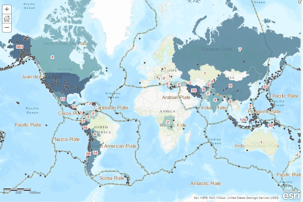

The result is below.  Now I have a better sense, with a choropleth map, of the frequency of earthquake by country.  Given a ocean polygon layer, I could even map oceans by earthquake frequency.
I would like to make just a few adjustments.  Because over the last 30 days, according to the USGS, earthquakes had occurred in only 42 countries, and 254 polygons exist in the generalized world countries data set, countries with no earthquakes have no symbol or color:
Spatial Join 8b

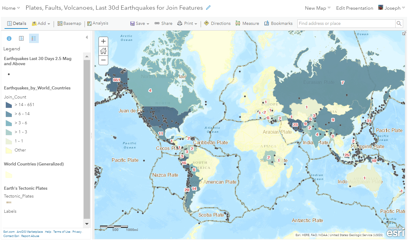

This looks a bit odd.  My goal is to show countries with no earthquakes over the past 30 days with a pale yellow color.  This is easily remedied with a few keystrokes.  The easiest way to do this is to use the Add Data button, add the generalized world countries from the Living Atlas of the World, and change its style to pale yellow with a yellow outline.  Once done, I moved its position to be located underneath my joined earthquakes layer.  I also moved the earthquakes to the top of the contents so that my map users could more clearly see them.  I also labeled the countries with the number of earthquakes that occurred within each one.   The resulting map is here.
Spatial Join 9
