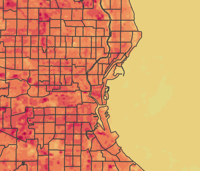

What’s the average summer temperature in US census tracts in Milwaukee? How is this related to tree cover? How about race?
(Landsat-2 showing average surface temperature in August from 1985-2024)

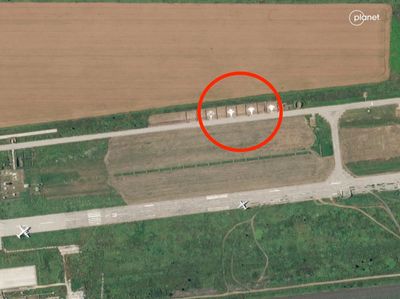

Why is Russia painting jets on some of their runways? What happens when object detection tools try to identify ‘jets’ in this imagery? Where is Russia doing this?
(Image courtesy of Planet Labs)

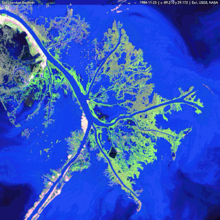

How much erosion has occurred in the Mississippi delta over the past 40 years? What does this change look like? What communities have been most impacted by this change?
(Animation in 4-year steps, created with the Landsat Explorer showing shortwave-IR between 1984-2024 of Venice, LA)
As a 1st year student in an introductory GIS section… I don’t care what band combinations were used in the animated Landsat image! I will also probably fall asleep when we look at the chart showing wavelengths and spectrums. But – I do want to know understand why this is happening. I want to know how to measure the change. After seeing these problems coupled with tools and methods to explore them, I want to dive in deeper.

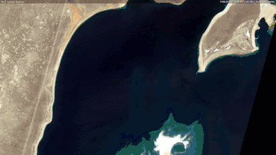

One of the locations that I was the most excited to explore when I first launched the application was the Aral Sea, located in present day Uzbekistan and Kazakhstan. In about 10 minutes, I was able to create an animation that used over 40 years of imagery to watch this once massive inland lake disappear.
(Aral Sea from 1988-2023 in 4-year steps)

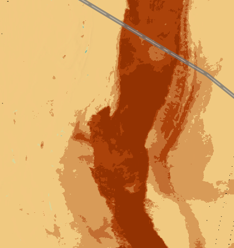

Even if the application only had these exploration and discovery tools, it would be an incredibly valuable resource. But for me, the ‘Analyze’ pane really takes the application to the next level. With the provided ‘change detection’ tools, learners can select between 2 different time periods, different indices, and then build an analytic result on the fly. Rather than simply swiping between 2 different time periods, or trying to ‘see’ the change, we can compute it. I can honestly imagine this tool filling the need for a whole week of lessons and labs, but there will obviously be times when you will need to go further.
(Visualizing the Aral Sea after using the change detection tool on the water index found in the ‘Analyze’ ribbon)

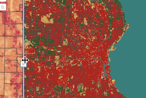

In one simple example, we can explore the relationship between tree cover and urban heat in Milwaukee Wisconsin. Using only the ArcGIS Online Map Viewer and hosted data, we are able to filter Landsat data based on time of capture and cloud cover, and then build zonal statistics for census tracts. We can add the European Space Agency layer for 2021 land cover, showing tree cover. We can also add data related to population health, race, or ethnicity. Hosted analysis tools also provide the ability to build a composite index, which lets us combine all of these inputs based on weights and ranks that we assign. Without downloading any data or building any raster pyramids, we can explore and measure the relationship between heat, population, and tree cover. In short, we can use tools and methods that pull vector and raster data seamlessly into one workflow. A workflow that engages, excites, and encourages learners to ask ‘how’ this all works on a deeper level.
