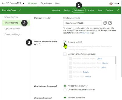

  1. After publishing your survey and while editing it in the Survey123 website, go to the Collaborate tab and choose Share results from the left side.
  2. Think about who you want to see the results: maybe it's your whole organization, or one of your groups. Perhaps it's everyone, and you’ll share it publicly. Choose the option for Who can view results of this survey? to match who you want to use your map.
  3. Most of the time, when sharing results you want to share all of them. That's the default. You might want to limit people to only seeing the results they submitted. If desired, you can do that in the What data can viewers see? section.

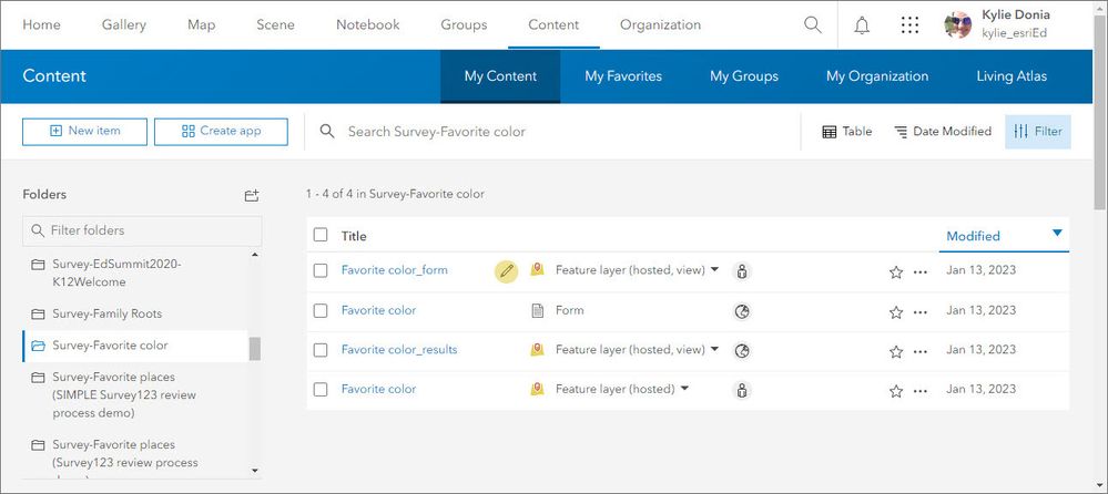

This configures a "_results" layer that you can now put in a map. You can see the layer in ArcGIS Online by going to My Contents and choosing the folder for the survey:
But wait, there are three feature layers! Yes, there are. So how do you know which one to put in your map? Since you want to map the results, use the one named "_results" (or, for older surveys, "_stakeholder").

While you now know what hosted feature layer view to use in your map of results, let's examine the layers Survey123 creates for you when you make a survey. You can see the layers in ArcGIS Online by going to My Contents and the folder for the survey:

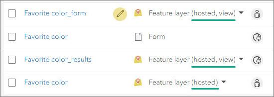

Creating a survey in the Survey123 website creates the feature layer (hosted) – this is the layer without anything appended to the survey name (in the example above, "Favorite color"). This layer is your big bucket of collected data. The data is stored in ArcGIS Online. You don't want other people accessing it directly, and you might have parts you want to keep secret. Keep it to yourself (you can see the person icon on the right, indicating it is only shared with the owner).
Publishing the survey through the Survey123 website creates the two feature layer (hosted, view) with "_results" and "_form" appended to the survey name (in the example above, "Favorite color_form" and "Favorite color_results"). These layer views are windows into your hosted layer. They can be configured to only expose some parts of the data, or some capabilities such as editing and viewing. They have a connection to the hosted layer, so their data always matches the current data from the survey while limiting its use. Each of these layers is configured through the Survey123 website for a particular audience and task.
  • The "_form" layer is shared and configured based on the options you picked in the Collaborate > Share survey tab.
  • The "_results" layer is shared and configured based on the options you picked in the Collaborate > Share results tab. It doesn't allow data editing, so can be safely shared with a wider audience you don't want to change the data, but just to view it.
Any of these three layers can be used in a map. However, the map will inherit the capabilities of the layer.
  • If you use the "_form" layer with a default configuration, the person viewing the map can only see the data they entered in the survey.
  • If you use the hosted layer, it won't be shared with the person viewing the map and so won't load. (And if you share it – which you shouldn't – they'll have access to all the data in ways you might not want them to have.)
  • If you use the "_results" layer, you'll end up with a map of results that works as you expect.
