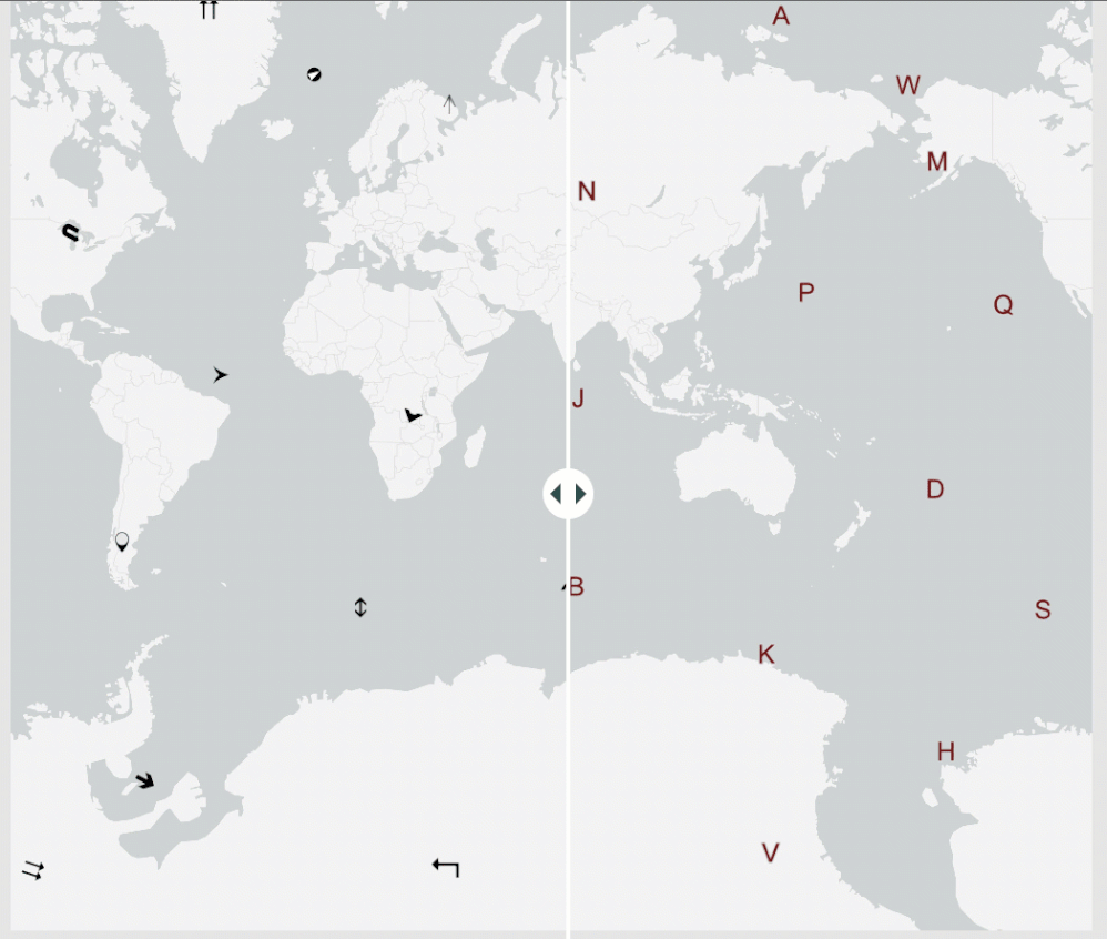

To set this up I created an empty hosted feature layer with a single letter field. I then edited the layer in the webmap and just randomly dropped points around the map. Each point got a letter of the alphabet. Next, I symbolized by unique symbols and choose my letter field. I gave each letter a random symbol. Hint: Play with the rotation to get more mileage per symbol option. Then I turned pop-ups off and saved the map. Then I Saved As to create a duplicate copy of my map. I turned on labels for this version and moved the label to 'center center'. Then I made the layer completely transparent. These two maps were added to a swipe block and voilà.
I then grabbed a screenshot of the symbols in the style panel and used Paint to create a message ‘ransom note style’ for my users to decode.
