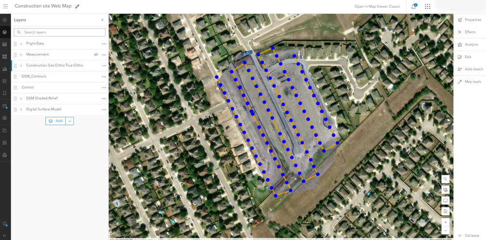

Sharing
Outputs from ArcGIS Drone2Map can be used directly in ArcGIS Pro or published as feature layer, tile layer, scene layer, imagery layer, elevation layer, catalog dataset or web map, in ArcGIS Online or ArcGIS Enterprise, for further editing and sharing.
2D outputs published from ArcGIS Drone2Map to ArcGIS Online2D outputs published from ArcGIS Drone2Map to ArcGIS Online

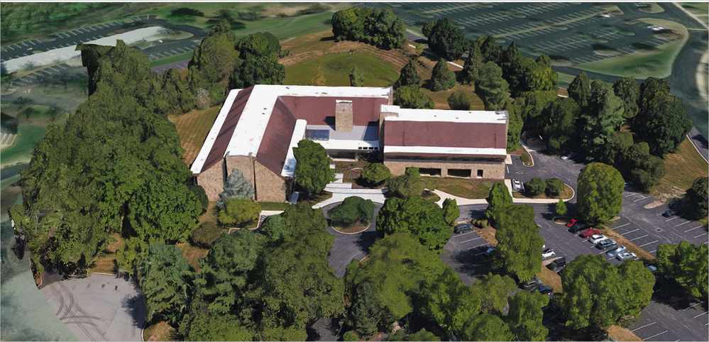

Creating 3D output products with an Advanced license
With an Advanced license, you can generate both 2D outputs and 3D outputs: point clouds, meshes, and textured models that capture the details and dimensions of your drone imagery and creating reality mapping.
Education pricing for ArcGIS Drone2Map Advanced license is available and significantly discounted compared to the commercial offering.  Contact your respective Esri Account Manager to get a price quote.
An example of 3D Mesh output from ArcGIS Drone2MapAn example of 3D Mesh output from ArcGIS Drone2Map
