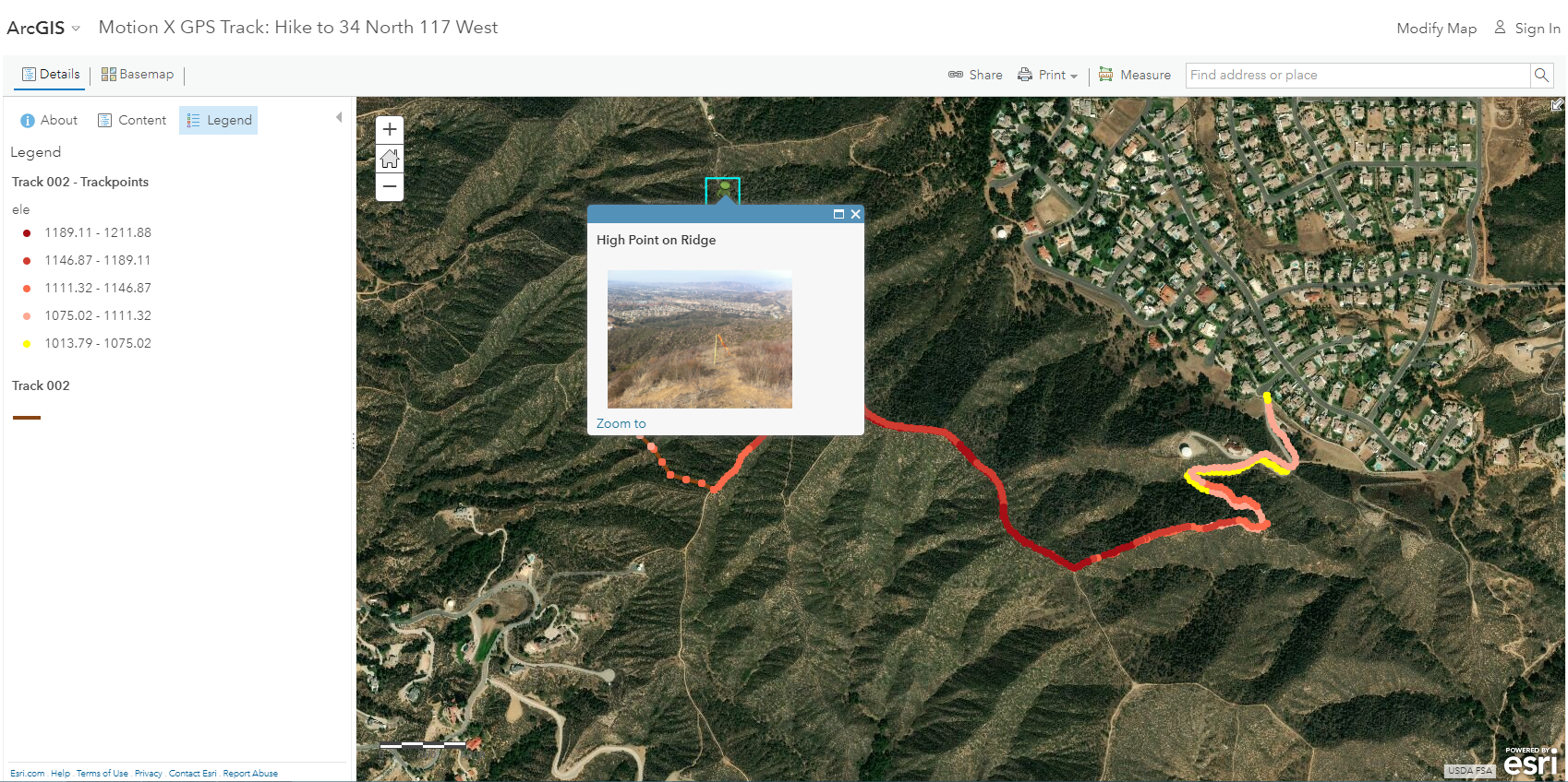

This map is entitled "Motion X GPS Track:  Hike to 34 North 117 West" by jjkerski and will look similar to the map below.

Explore the map and data layers.  First, click the Contents tab to the left of the map to view the layers.   You will note that the map contains 4 layers:  Map notes, track points, track lines, and a satellite image basemap.  Some layers expand when you click on their names in the Contents tab.  The track, for example, expands into points and lines.  This is because certain field data collection apps collect several types of spatial data simultaneously; in this case, the app that was used in the field collected point data and line data.  Each is useful.

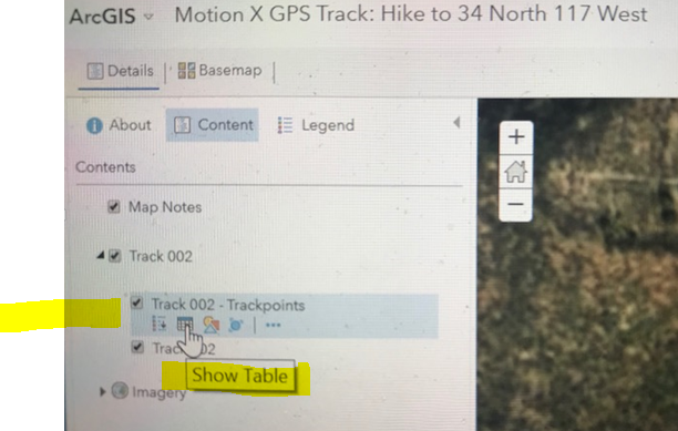

Second, open the table for the point and line layers, as shown below.
Field study 2
Note that the line layer only contains 1 feature, while the point layer contains 581 features.  The fields in the point layer include the elevation (in meters) and the date/time.  The point layer is symbolized by elevation, and if you take a quick look at the Legend you will see that the red colors indicate higher elevation and yellows indicate lower elevation.
Third, zoom out a bit to see the entire hike, noting the type of vegetation and terrain traversed, location of the beginning and end of the hike, which sections of the hike followed a trail and which did not, and the high and low points along the hike.  Change the basemap to a streets basemap to answer the following question:  At the west end of which street did the author park on to begin the hike?  Change the basemap back to imagery.
Click on the 2 pushpins to see the photos taken at those locations. These pushpins are “Map Notes” which you have used in this module in the past.

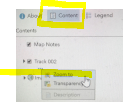

Zoom out further until you can determine the region of the world in which this hike was taken (the chaparral biome of southern California USA).  To zoom in to the hike, use the … ellipses for Track 002 > use “Zoom to”, as shown below:

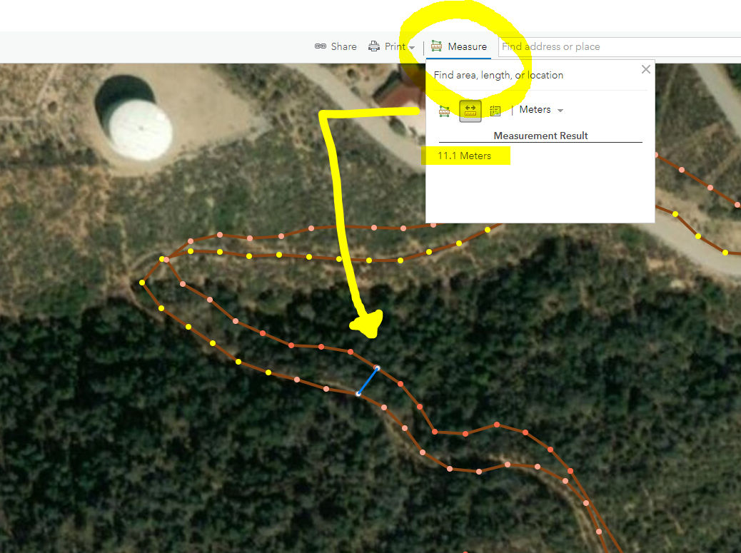

Fourth, use the Measure tool to measure the distance between each of the points that appear along the lines.  What is the average distance between each point for a certain section of the hike?

Be critical of the data’s spatial accuracy.  In keeping with the theme of being critical of the data, before leaving this data set, zoom to the eastern side of the collected data, near the white circular water tank.  Even though the person collecting the data (your module author) walked on the trail in this area going up and going down the ridge, note the offset from the trail for one of the tracks.  By examining the date and time stamp on the data, you can determine whether the offset occurred on the way up (climbing from east to west) or the way down (descending from west to east).  Measure the offset of this section of the track from the trail as shown on the satellite image, as shown below.
Field study 4
The points could have been compromised in terms of positional accuracy for a number of reasons, including:  The field worker could have inadvertently shielded part of the phone with his hand while gingerly picking his way along the trail while collecting the track, the cell phone reception might have fallen off, dense vegetation or the high ridge to the west could have prevented the phone from sensing as many cell phone towers, wi-fi hotspots, and GPS satellites as it had done along the ridgetop, or the app might not have been recording accurately here.  This compromising of positions happens when using GPS receivers, as well, and is something you and your students need to continually be examining and questioning.  It happens most often near ridges and canyons, such as in the case here, but also in city centres with high rise buildings, and also from within a building or when the field data collector first leaves a building and enters the outdoors.  Discuss with students the different accuracy requirements depending on your project.  For mapping trees on campus, being a few meters off might not be a problem, but it would be a problem for objects spaced more closely together, such as mapping headstones in a cemetery, or pieces of litter on a city street.  Discuss the even finer accuracy requirements for such things as mapping natural gas lines or fiber optic cables.
