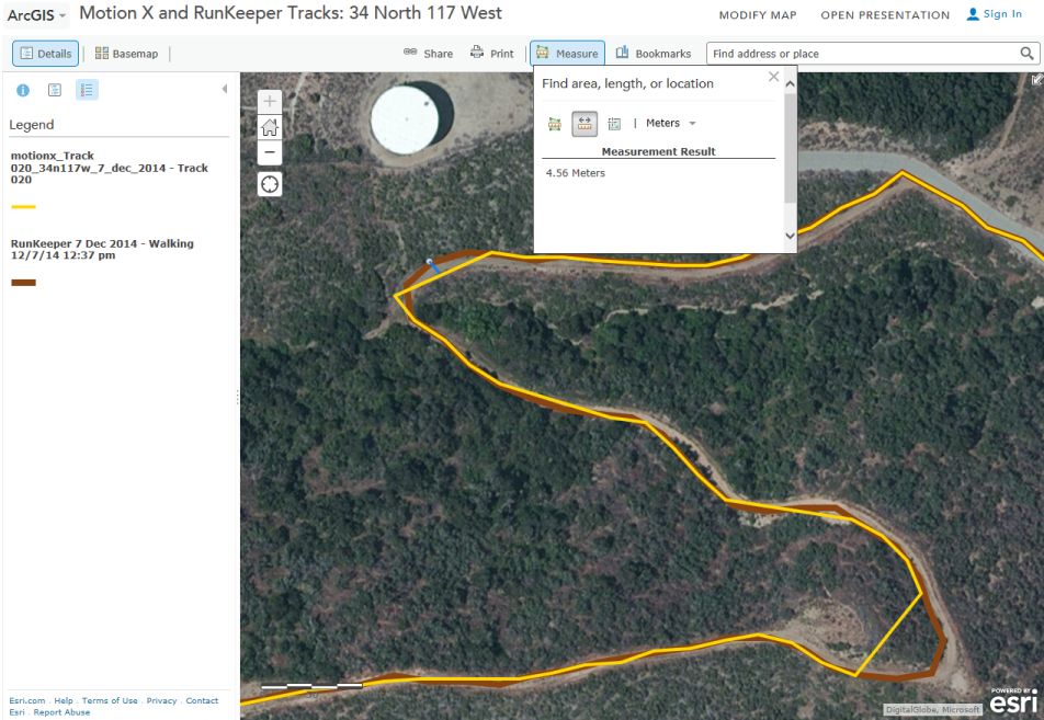

On a hike in the chaparral hills of Southern California, I used my smartphone to collect my tracks using two apps--Motion X GPS and RunKeeper--at the same time.  Once the hike was done, I then exported the track lines and points as GPX files and uploaded them into ArcGIS Online.  The results, shown below, indicate that the two tracks were quite similar; within 1 meter of each other.  I was pleased with the spatial accuracy of both, despite the very steep terrain and considering that the phone was in my pocket most of the time rather than held up high to capture a theoretically stronger set of GPS and cell tower signals.
It was also evident that in this location, on this day, RunKeeper was a bit more spatially accurate, doing better at maintaining the trail switchbacks as I walked rather than cutting them off.   At one switchback, the two tracks were separated by 4.5 meters.  However, just downhill and to the northeast of the image below, Motion X was more accurate for a specific 10 meter stretch of trail.  It must be remembered, however, that these statements "assume" that the satellite image is the best benchmark of spatial accuracy, but it too contains distortions and error.  Furthermore, on a different day and time, with the GPS constellation in a different array, my results could vary.  Varying the speed walked, the time and date, the location app, the location at which the phone is held, the type of phone, and other factors all make for easy-to-implement field investigations that incorporate science, mathematics, geography, and geotechnologies.  And, while outside, you can have rich discussions on land use, land cover, natural processes, access to open space, animal habitat, climat....  The results are easily examined using ArcGIS Online, and students can also create a presentation or a story map in ArcGIS Online to communicate their results.

Comparing the spatial accuracy of two smartphone location apps in the field.
