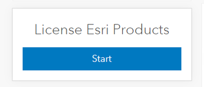

MarkStewart
Hi @GregoryLund2 .
To create the single use license file for ArcMap, you will login to MyEsri, and click the Licensing tab.  That tab will display the License Esri Products button in the left sidebar:
When you click the button, it will start a wizard that guides you through the license file creation process.  For your ArcGIS Desktop (ArcMap) single use license file, make sure to select "Core products and extensions".  All of the ArcMap extensions except for LocateXT and Business Analyst are bundled into the license file by default, but you will be able to add these two discretely later in the wizard.  At the end of the process, you will be given the ability to download the new file, and then you can share it with students through a file share, as Geri suggested in her post.
This license file will time out at the end of your license agreement term, so when your agreement is renewed, you will create a new one and ask students to use that one instead.
We are planning to create some very short videos for MyEsri tasks like this.  They should be release soon.
