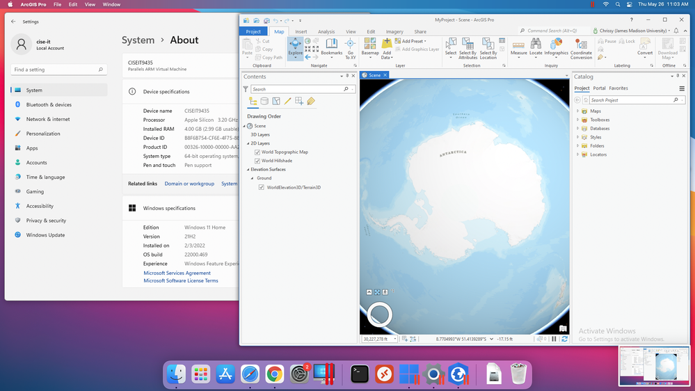

Hi all. Just want to comment that I've been successfully using ArcGIS Pro in Windows 10 ARM Preview on an Apple Macbook Air with M1 chip for a couple months. It works great.
My use case is primarily development of toolboxes and scripts supporting integration with my company's APIs. I also have a need to use the Enterprise SDK but Visual Studio is not yet supported on Windows 10 ARM. I haven't done much heavy spatial analysis or any cartography.
Both the M1 chip and Windows ARM are surprisingly good. I've been really happy with this configuration. I've also got an Ubuntu 20.04 ARM VM available that works just as well.
My only regret is getting 8GB RAM. Would recommend 16GB, which is the current max supported by the M1 chip. 64GB will be supported on the rumored M1X or M2 set for late this year or next.

Just installed Parallels Desktop 7 on Macbook Air M1 (16gb memory). ArcGIS Pro 2.8 works well, even with 3D scenes. So good so far

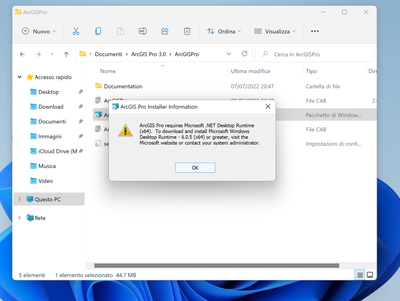

@fstring or anyone else with experience of Win11 ARM & ArcGIS.  I can get most everything working with a few exceptions:
1) On the lastest 10.8.2 Build of ArcMap, the 64-bit background geoprocessing add-on will not install properly due to a "ArcGIS Desktop Background Geoprocessing requires Microsoft Visual Studio C++ 2015-2019 Redistributable (x64) 14.22.27821 or greater to proceed"..  Installing the latest ARM64 or X64 package from MS does not solve the issue, has anyone encountered this issue and found a way to complete the installation?
2) I cannot install the ArcGIS License Manager 2021.1 (or 2021.0).  Earlier versions WILL install but will not authorize the product in a concurrent use license situation due to reported version incompatibility of the (older) FlexLM servicing component.  This seems like a FlexLM issue.  When I try to install the newest version of the license manager I get a similar installation error "ArcGIS License Manager 2021.1 requires Microsoft Visual Studio C++ 2015-2019 Redistributable (x64) 14.27.29016 or greater to proceed".
