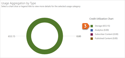

  3. Scroll down to the Usage Aggregation by Type chart. Click Storage (in the ring or legend).Org-StatusTab-Storage.png

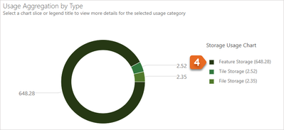

  4. Click Feature Storage (in the ring or legend).
  5. In the table below the chart, click the line for Standard Feature Data Store.
  6. Click the blue View item details button below the table.

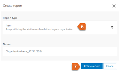

  6. Chose a report type of Item.
  7. Click Create report.

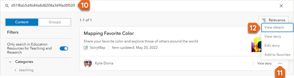

  10. To review an item, copy its Item ID from the spreadsheet and paste it into the search in ArcGIS Online.
  11. On the search result, click More options (the three dots).
  12. Click View details to see its item page. You can read more about it and manage the item, including moving or deleting it.
