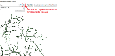

Hi @AnneYvonneBlin
This app does it display a diagram created with ArcGIS Pro version 3.1?  I can see published services and generated diagrams in the dropdown list. But it does not display the diagram in the right panel.
AnneYvonneBlin
@GIS_Solutions,
It should display as you expect whatever your Utility Network version and whatever the version used to create the diagrams. I've just tested and it works. Any 3.1 diagram I create with the webapp or create/store using ArcGIS Pro then load using the web app correctly displays.
The only limitation I can think about concerns the layer definition you set up on the related diagram template. As explained below, it doesn't work properly when subtype group layers are used for diagram layer definition, but even with subtype group layers, you should at least partially see diagram parts.
NOTE: once you clicked the Display Diagram button, you may have to wait a few seconds before the diagram loads. This is particularly true the 1st time you open a diagram based on a given template for which the template layer definition is not already loaded on the server .

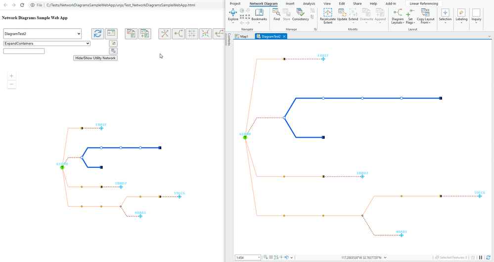

AnneYvonneBlin
Hi @gpgisandsky
This sample web app only works with "standard" layers for network diagrams. It doesn't work properly when subtype group layers are used for diagram layer definition.
However, if you set up custom diagram layer definition on your diagram template and this custom layer definition is based on standard layers, you should see your symbols and labels for any diagrams based on this template whether you open them within ArcGIS Pro or using this sample web app.
See the same diagram open below through this web app (left side)  vs. within ArcGIS Pro (right side)
If you need some guidance about diagram layer definition, see https://pro.arcgis.com/en/pro-app/latest/help/data/network-diagrams/manage-diagram-layer-definitions...
