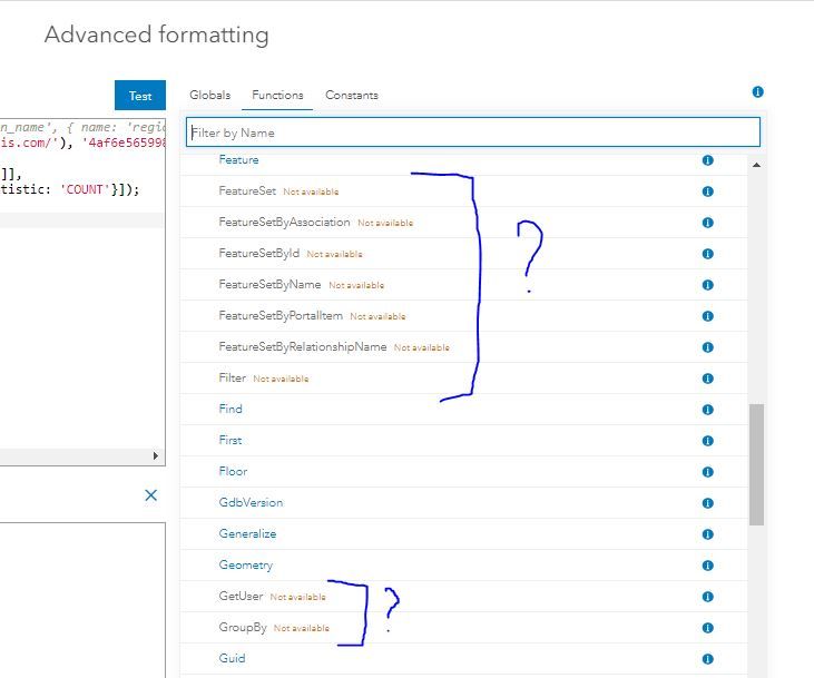

Hi All,
I started playing with the AGOL/Dashboard/Advanced Editing/Arcade and found there are some functions not available for me. Could anyone shade some lights why they are not available?
Thanks,
5 Replies
jcarlson
MVP Alum
Check out the Profiles page of the Arcade docs. Certain profiles, like working in Dashboards, don't have access to the same global variables that, say, a popup expression might.
Functions which utilize such global variables will be unavailable in such a case.
With Dashboards in particular, the Arcade is already evaluating against a FeatureSet as defined by the element's selected layer, filter, and sort options. Or if it's a per-feature Indicator, for example, you're actually working with a single Feature object, and not even a FeatureSet. In either case, you won't have access to other layers, or even other attributes within the same layer in some cases.

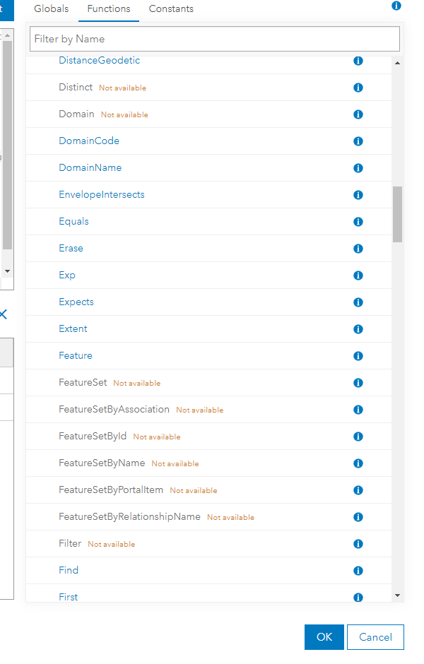

Hi,
I have posted something similar yesterday, I cannot use "FeatureSetByRelationshipName" for no apparent reason. The Arcade expression fails while testing popup configuration expression.

DarrylAlbert
I am having this problem on a hosted feature layer.  Any idea why that may be?

Ryan_Gould
I had the same issue. I was trying to use a list element with advanced formatting to calculate some statistics. I got it to work by creating a data expression and adding this as a layer in the element.
