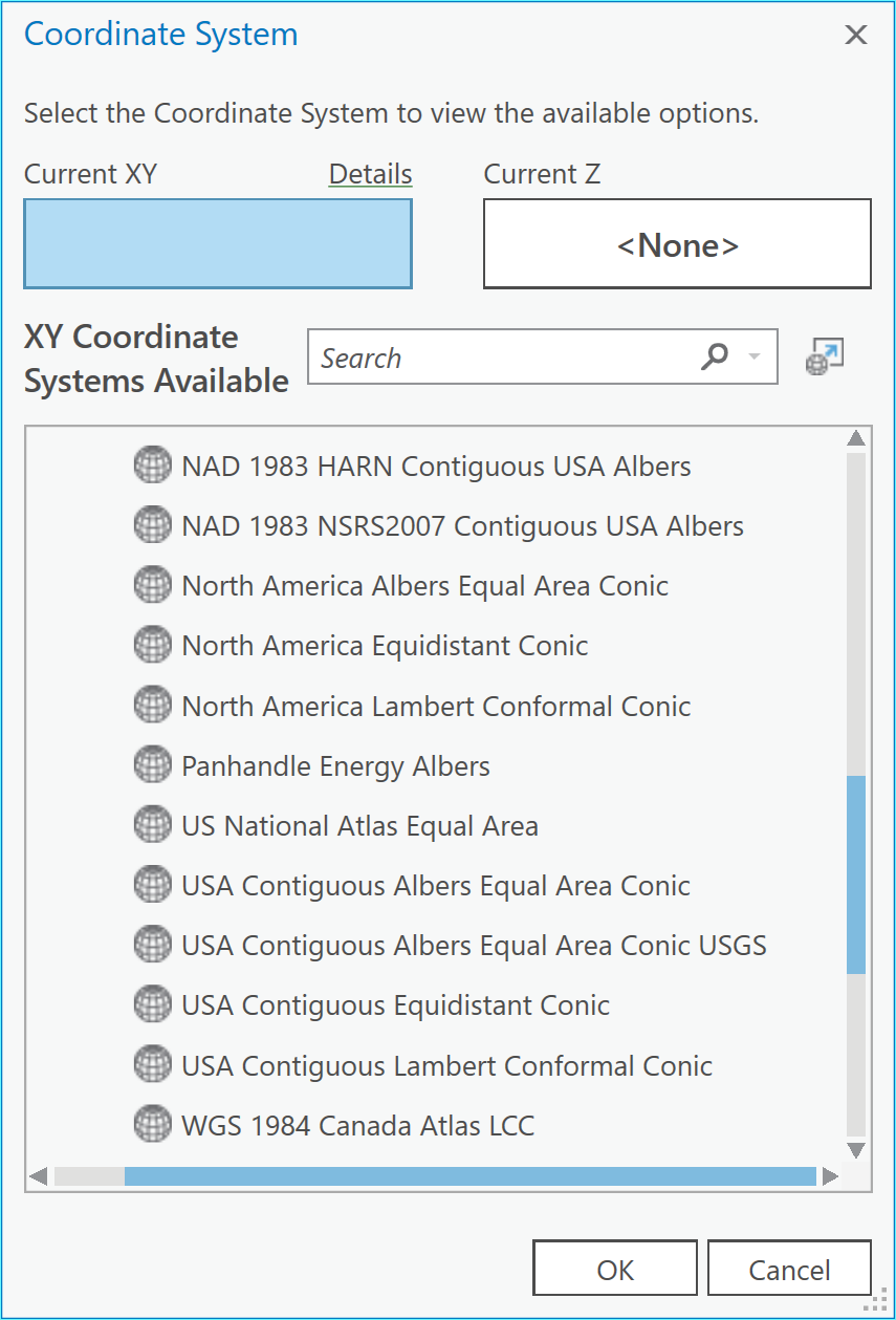

What is the best, depends on your spatial area coverage.  You can begin your journey in many ways, but I find the interface from ArcToolbox the easiest to remember
do some reading, start with what is used in your area, or by the federal gov't etc.  There are lots of choices lambert's and Albers variants tend to be recommended depending whether your E/W extent is wider than your N/S.
Others will weigh in with opinions, the above guides you to the 'where are'

remember, that the continental scale ones are best for a well spread out set of data... if all your points are on one coast or the other, then you might begin to examine those at a more regional level or even State-based.  Good luck... but do check what is used by the various levels of government.  Here in Canada, they are pretty specific as to what they use on a country and province wide basis
