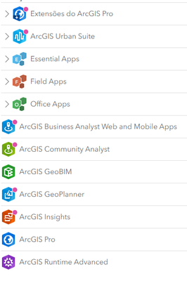

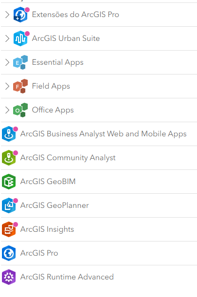

the account have that authorizations:
and the user type is GIS Professional Advanced.

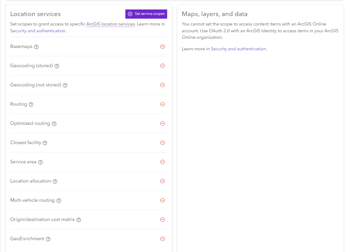

The api key acesses are:
Thank you for your time and help!
John-Foster
@allamympplease check out this page https://developers.arcgis.com/kotlin/license-and-deployment/get-a-license/ - it explains how you will need to get a Runtime Lite License key to license your app in this manner. The Lite key is free, you just need to log in with your account and it should generate one for you. Scroll the page to the license key widget https://developers.arcgis.com/kotlin/license-and-deployment/get-a-license/#your-lite-license-string
