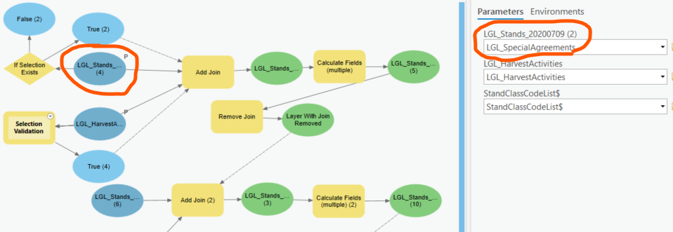

I keep having an intermittent issue with several different models. When I run them from the toolbox, one or more of the original input layers will randomly change to a different layer. This mostly happens when I reopen my project the next day, but not always. Sometimes the underlying layer within the model properties changes, sometimes is does not, but the labels always stay correct.
I found that when I open the tool from the toolbox and before running it in the geoprocessing pane, if I switch to a Layout and then back to the Map view, the tool refreshes and often changes back to the correct layer.
The input layers are hosted feature services and I have them set as parameters. I'm using Pro 2.8.3.
Am I doing something wrong, or is this a bug, or just a refresh issue? PLEASE HELP
See the picture below. The top two parameters are my input layers. You can see that the first one changed to a different layer in the dropdown. But the correct layer is shown in the model, and when I open the tool properties everything is correct this time (sometimes it changes though).

Thanks! At least I'm not the only one. I was finding that even though the layer changed in the parameters, when I export the model to python, the layers were correct. Seems like there's a little glitch in there on the model builder side of things. In most cases, my parameters didn't need to change anyway, so I just ended up removing the parameters to run the tools.

Nope. Most of the time it seems adding/removing layers to the map is the culprit, but not always. In model builder, when you hover over the tool it appears to show the correct layers, but when you open the tool it doesn't show the correct layers. I always run my models through the toolbox. If the layers are set as parameters in the tool, I just change it to the correct layers and the models runs correctly as it's supposed to. Or just remove the parameters and the model appears to run correctly as well. Hope this helps.
