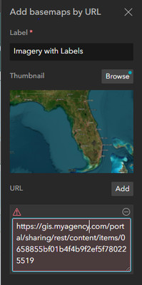

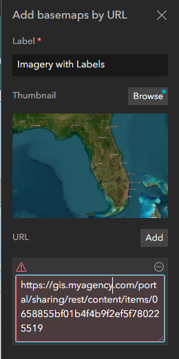

Not sure if this is the best forum for this question since it involves EB Developer, but I'll just post in multiple spaces. We are migrating all of our web applications (mostly built with WAB or EB developer) from on premise servers to Azure Cloud (ArcGIS Enterprise) servers. This also means that all of the associated data, web maps, etc. will also be migrated which requires re-sourcing the applications and all associated widgets to the newly migrated maps and data. This cannot be done from within the developer environment (gui) which leaves us with 2 options. Rebuild the applications in the EB Dev version registered to the portal to where the associated maps and data have been migrated, or use a code editor to modify the app config files with the new map ids, and layer urls. Since we have over 20 apps to migrate, the first option is not viable and I have been successful modifying the config files without breaking the apps. The side effect to this strategy is that that I am now editing an application in a version of EB developer registered in a portal that doesn't match the portal where the map and data are located. Because of this, even though I created a custom BM Gallery containing US Edition basemaps in the target portal, I have no way of importing them into the Basemap Widget. Also, unlike the success I had with the web map and other data sources, modifying the BM Gallery json in the config file doesn't work for some reason. I also tried adding the basemaps by URL, but I don't know exactly how to configure the URL correctly. I can tell you that if I paste the URL into a browser window it take me to the ArcGIS Portal Directory page for the item and the BM Gallery is also shared with the public. Appreciate any ideas on how to proceed, or does this require a custom Basemap Gallery widget? Not sure what's going on under the hood with the Basemap Gallery and I really don't have the time to try and modify the widget code.
