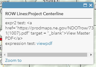

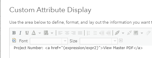

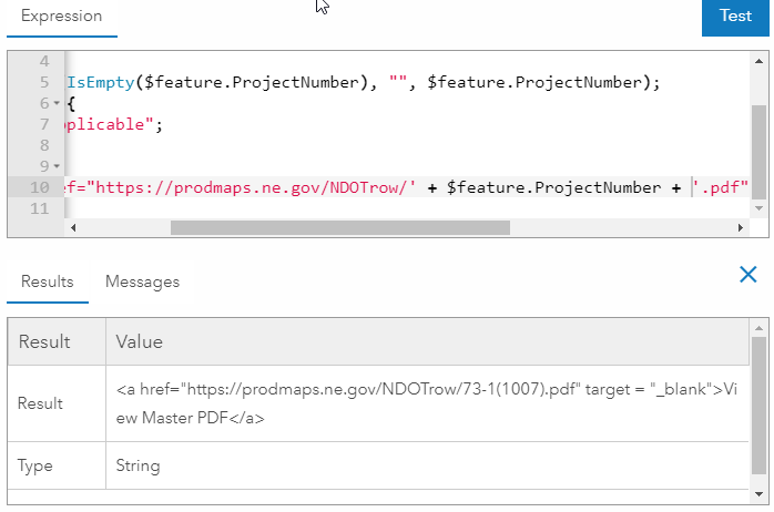

My working configuration :
custom expression added ({expression\expr2}):
configured attribute pop-up:

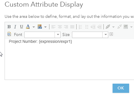

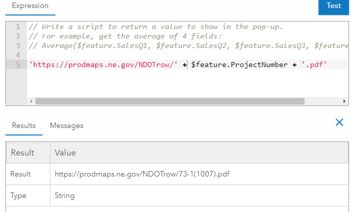

My NON-working configuration:
{expression\expr1}
configured attribute pop up:
returns "expr2 test:"
Why does the working configuration recognize it as a link, but the NON-working configuration not recognize the pop up item as a link?

ChrisWiebke
I don't have permissions to change the files in this directory.  The way I have it configured, would return this url:  https://prodmaps.ne.gov/NDOTrow/73-1(1007).pdf , which works fine.  Can you elaborate on why the parenthesis might be mucking it up, before I make a request to change any file names in the directory.  thanks.
