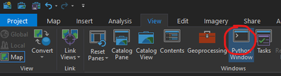

Probably Python.
In ArcGIS Pro, open the Python window:
Edit and run this code:
