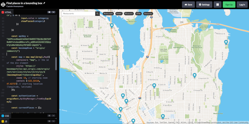

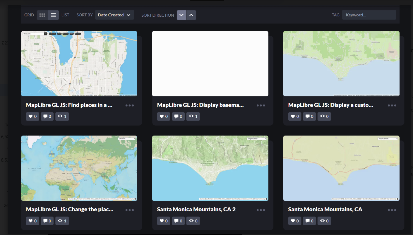

Currently I am stuck here with six tutorial maps on codepen and I don't know how to get them back on ArcGIS Online. Can you help me publish them, please?
Here's what they look like: As you can see "Display basemap"  did not print up. "Find places" started showing hotels and restaurants, etc after George showed me how to add places to the API Key. The tutorials are a trip, and I'm liking the journey, and as before in my esri GIS journey, there are places where one gets stuck. I would appreciate your help.
Here's the tutorial for "Find places in a bounding box" to show you what kind of tutorials I'm doing: MapLIbre and Codepen. https://developers.arcgis.com/maplibre-gl-js/places/find-places-in-bounds/
Thanks!

@RonaldHaugGreat to see you made so much progress with the developer tutorials. I'm not sure what you mean by getting these apps back on ArcGIS Online. These code samples are designed to be run from your own app or website. If you want to run these on ArcGIS Online you should try to use Instant Apps or one of the other app builders.
For the Display Basemap, we would need to review your Codepen, but your screenshot looks like the API key used is invalid or not correctly set to scope basemap privileges, so check your API key setting on that one.
For the Places sample, you will need an API key scoped to basemaps, geocoding, and places. I ran the tutorial directly off the page you referenced and added my API key and it works without any other changes.
