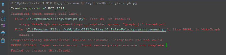

I am creating graphs using arcpy and facing this error while I give the input layer from the mxd.
Error while executing
In case, if I give the input from direct shapefile, then graphs are generated. Kindness is required in this issue. The code I have written is given by:
